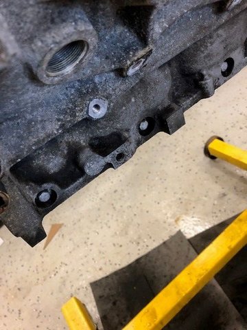

Well I seem to be stumped at this point in my build. Using an L33 block in a swap, and have to use a front sump oil pan, which does not have a provision for a dipstick. I was going to machine something and weld it on to the pan, but after filling the pan to the capacity, there is no room for a stick (the hole for the dipstick would be submerged so I don't want to go that route).

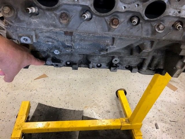

The block has a drilled boss at the rear for the dipstick. This one I obviously need to plug, but has anyone added one to the front of the block? There is no casting boss. The only place I could see that may be doable is a 'horizontal' boss, that I would have to machine at an angle. I am unsure what this boss is for. It looks like it would clear the counterweights and crank though if used. (Pointing to it in a picture)
Has anyone done such a thing? If not, any other suggestions (besides "Measure the oil when filling and change often")?
The only other thing I can think of is a sight glass, but that could be a whole other can of worms.

I haven't seen any L33 blocks drilled for a front dipstick, yet L33's came in trailblazer SS that had a front sump pan.
I'd assume the dipstick goes in the pan on those?
And didn't GTO's have a front sump pan?
Do you have the pan yet?

I'd machine a block of aluminum and weld it to the outside of the pan, then drill through the block and pan at the same measurements of the rear sump dipstick hole.
I had all the same questions.
I remember seeing, just stay with me for a second, where I've seen a tool that bolts to the block and is basically a drill jig to drill a dipstick.
I've only seen this once and I can't remember the context nor the specifics.

Thanks guys! I do have the pan, but it's a Holley/Weiand 5042 (I believe that's the number) front sump. It's, errr, not a great pan. (GTO pans are getting a little overpriced it seems).
I machined a piece of aluminum today so I believe I will be welding to the pan, which I wanted to avoid, but if nobody has successfully machined and drilled a new dipstick hole in the block, this seems a little safer.
