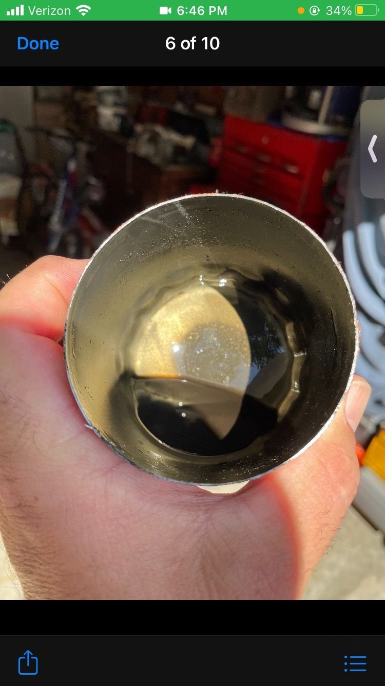

Cut the oil filter open and inspect it.

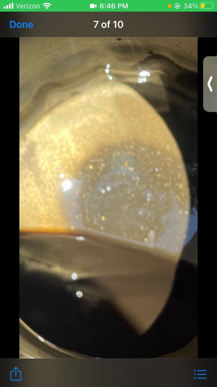

LilJayV10, I have cut open the oil filter and below is a picture of what I found. You can see some metal shavings as well as the brass shavings witch only come from crank bearings. I still do not think I have a spun bearing, my engine doesn't knock and I have oil pressure. There are videos on youtube of LS1's with spun bearings and they idol normally while having very obvious rod knock. My car does not idol, and does not have any rod knock when I try to start it. Do the small brass shavings in the oil indicate that I have a spun bearing? Or is this normal for freshly rebuilt engines?
Thank you all for your help.
