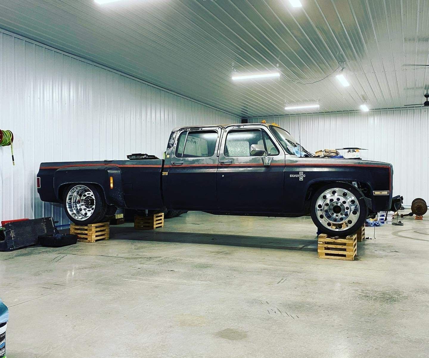

what’s everyone running cam wise and intake wise? i’ve got a 6.0 that’ll have 706 heads that’ll be decked, want something that’s got a nice chop at idle but will also perform. i know not to select a cam off of sound so i can sacrafise that. i’ll be pulling a few trailers throughout the year (maybe 1-5 times)
but mostly daily driving/road tripping so don’t want it to be a top end only cam, 4l80e and 3:73 gearsPFA of what it’s going in

Looks like a twin to mine...I'm running the same combo your going to use in my 86...

I want a square crew dually sooo bad. Nice looking truck, that is all.

There's something about a big ol' square body crew cab dually! That will definitely be a looker
