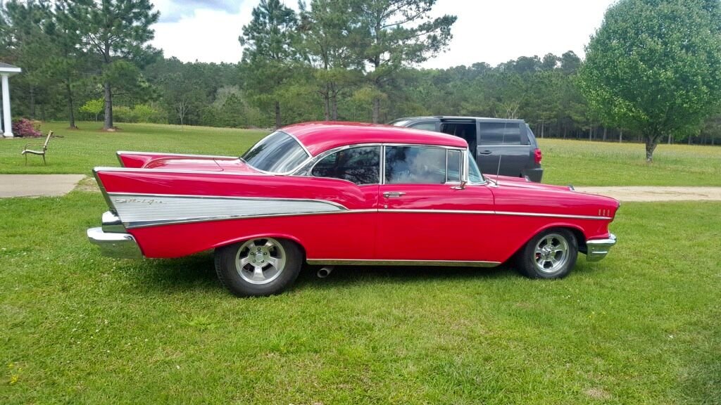

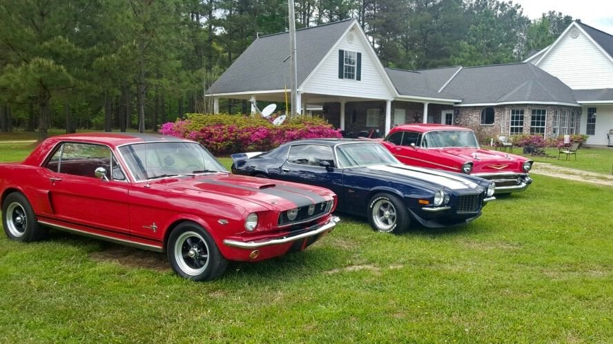

Thanks for all the help. Probably won’t get this done for a few months depending on work.
Here’s the family fleet

Now THAT'S a yard full of classy machinery!!
