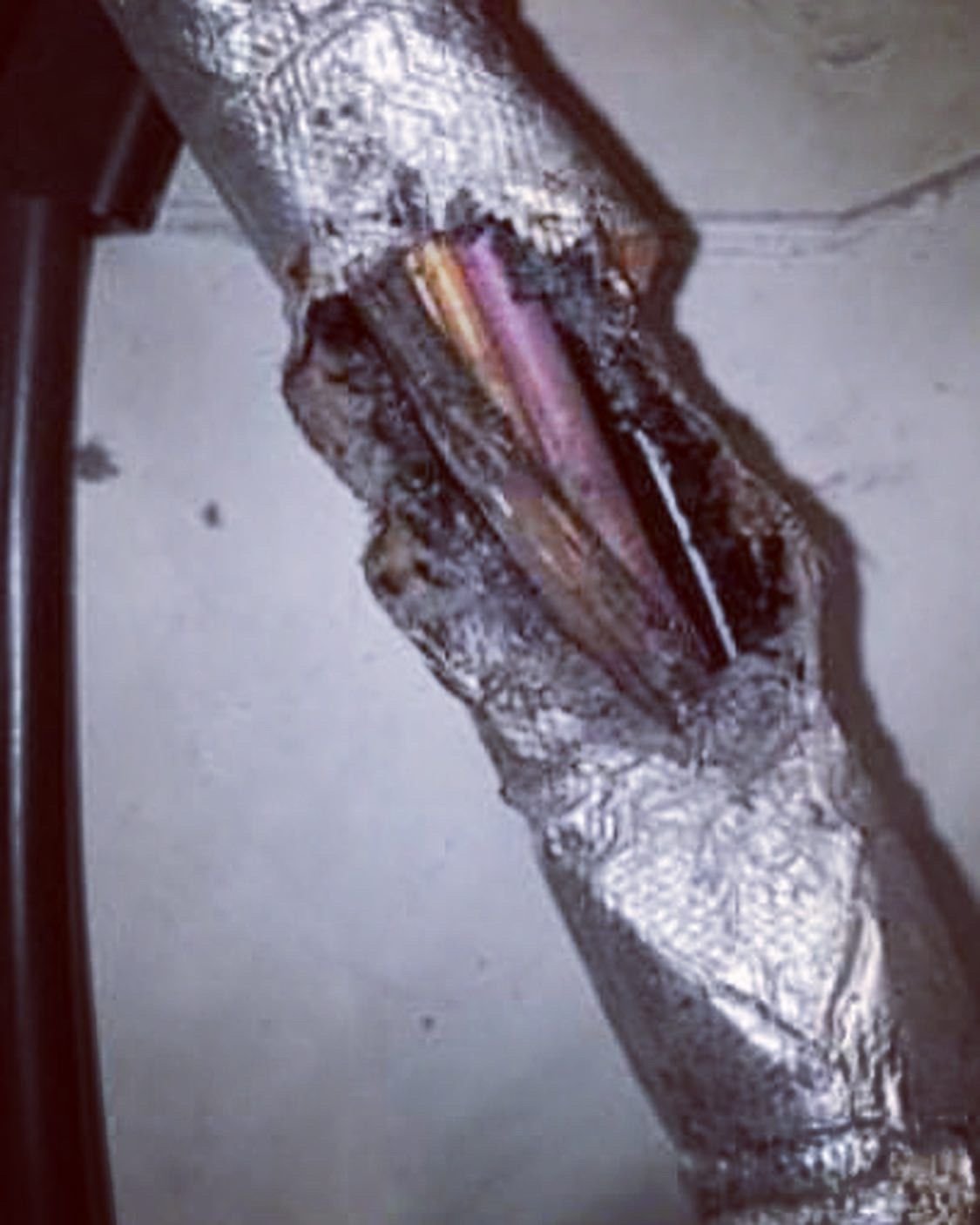

I know it probably doesn’t make any sense but hear me out first. 5 months ago my 99 TA started hesitating, jumping, dying, no throttle response, while out for a drive so I made it home. No codes but I Hooked up the code reader anyways and it was saying bad crankshaft sensor. So order a new one and it didn’t fix it. Car won’t even drive, starts occasionally but dies.
fast forward to two weeks ago and find the wires running to the crankshaft sensor, starter, etc. we’re burned by the headers.fix it. Fire up the car, starts and runs. I noticed it would reset my trip odometer every time I started the car, (never happened before) and the car was slightly hesitating or throttle response would leave for a split second, once every 5-10 miles, and would come back on. Then I realized I used a cheap Chinese Amazon crankshaft sensor and these things like the ac delco ones. Change it out last night, didn’t get to drive it much but it seemed to be better. Didn’t notice any throttle cutting out AND the trip odometer isn’t resetting. It’s holding its miles. Checked again this morning and it’s still holding.
I didn’t remove any wires/grounds while replacing the crankshaft sensor. So could that sensor have something to do with the trip odometer working correctly now that a good sensor is in? I wouldn’t think it would, but it’s a weird coincidence that it stopped messing up when I changed it to a good one.
