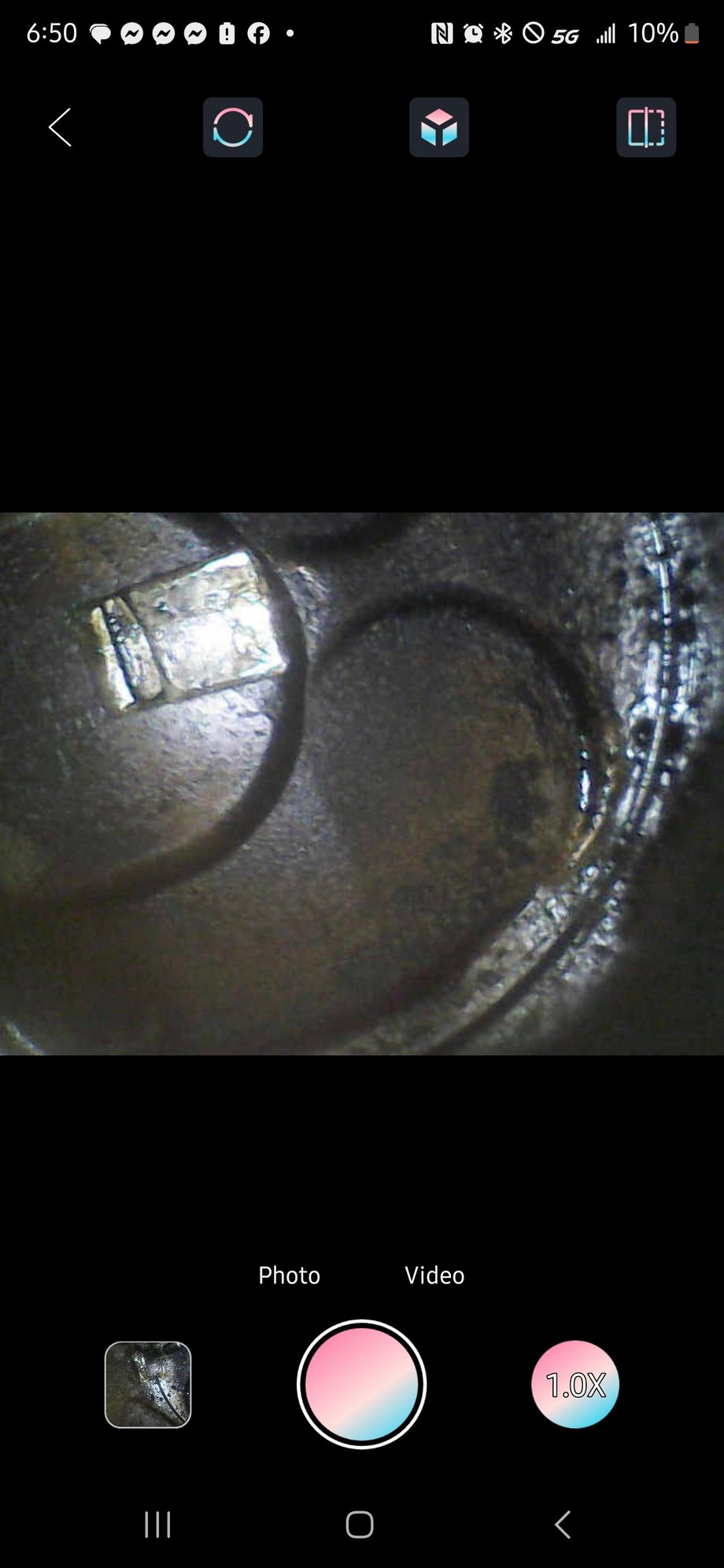

So I tried everything to get this valve keeper out.Tried sticking a magnet in the spark. Plug hole, try getting a little claw. A thing to get inside there and grab it while looking at it with the endoscope. But I can't pull it out while looking at it with the endoscope.Any help I can get would be really Appreciative.

Wheel bearing grease on a coat hanger??

Magnetize a piece of coat hanger wire.
