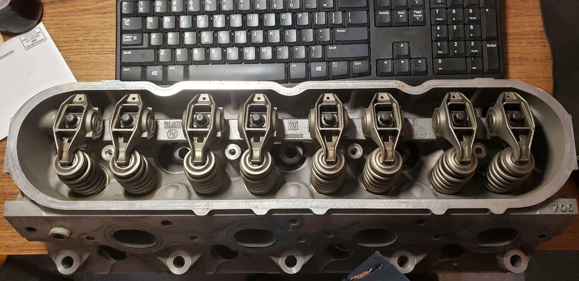

Originally Posted by bufmatmuslepants
Update: new cat and it still wasn’t running right, so I had it towed home to do further investigation on my own. Pulled codes and saw a P0106 for MAP sensor which was weird. After running it for a minute, took a temp gun to the manifold and 8 and 4 were hot, 6 was cold, and random cylinders on the driver side were also cold. Did a compression test and had 130-150psi on all cylinders except 6, which had 0. Pulled rocker cover and found the exhaust valve spring was broke and pushrod slightly bent. Picking up a new spring and pushrod today at 3. My theory is the exhaust valve hung open 1/4 inch was pushing spent gasses back into 6 and back into the intake manifold every time 6 went to intake, causing the random misfires on other cylinders. Fingers crossed it’s fixed in a couple hours.
Glad to see you figured it out but haveing a broken valve spring would concern me that others could follow. Another thing I noticed was that your rocker arm pedestal is upside down. I have a 2005 Tahoe with a 5.3 and 706 heads which just so happens to be off of the motor and I can assure you that the GM logo should be upside down and not the way it's shown in your picture.
This is how it should look when installed correctly and this does have an affect on the rocker arm geometry.
I have 862s, and this is the first time the valve covers have ever been opened. That is interesting.

I have some 862's which are essentially the same cylinder head. If you don't believe me pull the rocker arm stand off and take a good look at the pedestals and you'll notice they are higher on one side than the other

Wow. You would know, having the truck in the family since new.
How much difference does it make in the geometry to have them oriented wrong, or "legible"?

Confirming this now!
