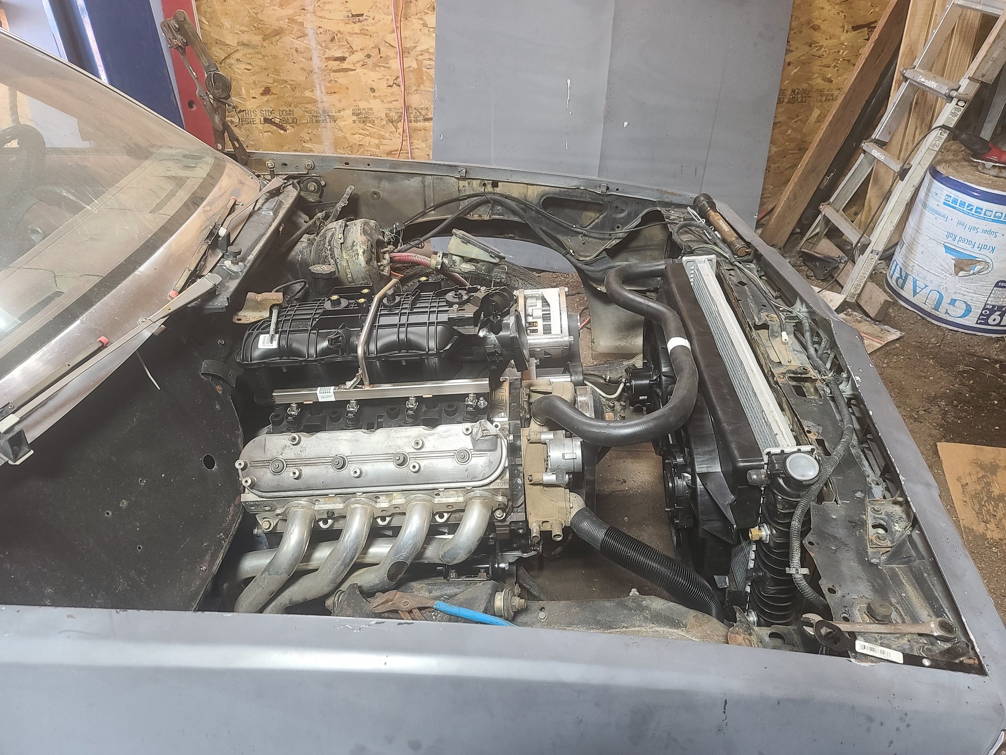

built many bbc engines. this is my first ls build
6.0 with wiseco pistons flat top with valve reliefs
243 heads no porting btr dual spring kit. milled .030
Stage 4 Pro LS Cam 238/246 113+3, .625/.605 Lift, Maximum power version
long tubes, tbss with a fast 90 dbc and 50lb injectors
powerglide 8in 5000 stall
4.56 28in tire 3000lb g body
this is mostly 1/8 mile drag car, with above parts thought on hp and what rpm. no dyno close to me will tune with holley terminator and some help
should i chg anything with limited budget, cant afford fast lsxrt manifold this year
l have searched alot before asking questions. hope this is a good spot for the questions
