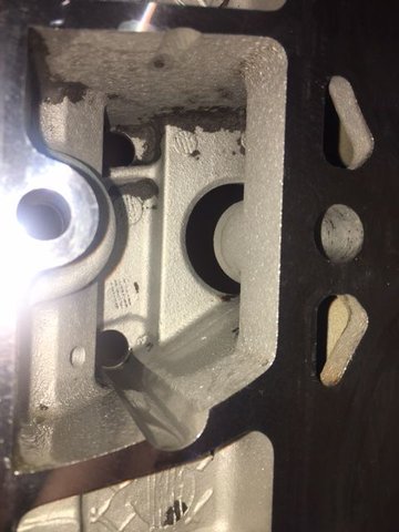

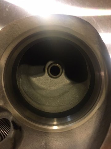

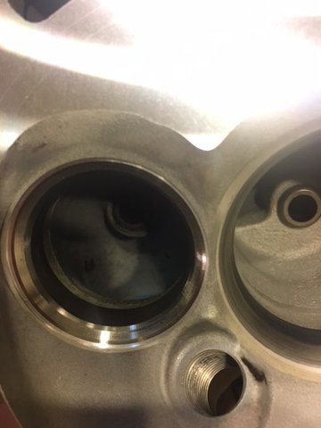

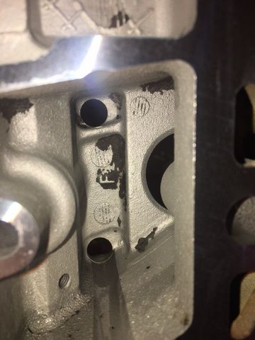

Got my set of 243 heads back from the machine shop awhile back from being milled and having a 3 angle VJ. they are clean upon first inspection but when looking from underneath there is residual dirt build up as shown in the pictures. I wouldn't think dirt cycling through the engine oil would be a good thing so maybe this is a dumb question but is this worrisome? Since the ls1 doesn't have priority main oiling I would think that dirt from the heads could travel unfiltered down to the bearings? Also included is a pic of the valve job. Thanks

I would take them to a shop and have them thrown in a parts cleaner. Inspect to make sure they are clean afterwards and then call the shop that did the work and tell them about their shotty inspection process after they are done with their work.

Sounds like a plan. That original shop was also suggesting a parts combo that would put me at 0.017 quench height and this was just one of their very questionable suggestions. Also had to order different main bearings as they had some around 0.028 on my aluminum block with the standard bearing set they ordered me. Not the greatest experience but I have learned a **** ton about engine building.

02*C5 said it well.
Definitely inspect very carefully.
