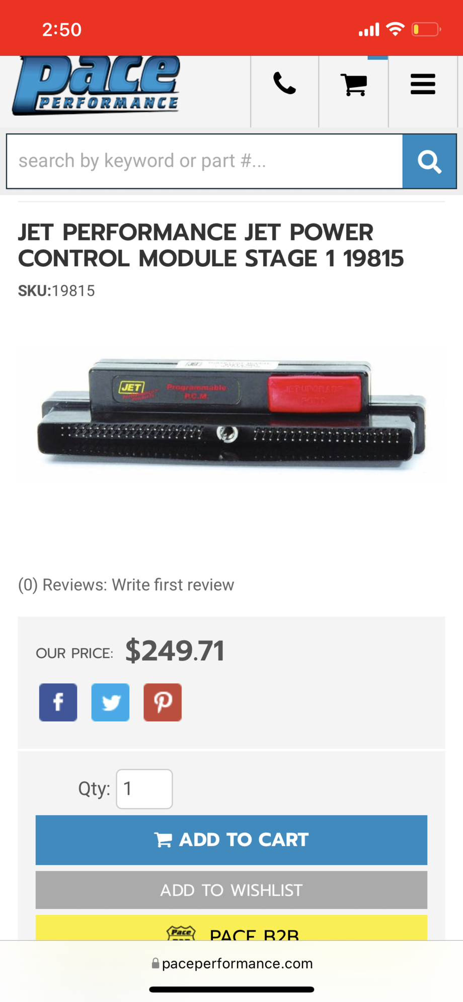

I should also mention the car came with an unknown set of long tube headers installed and weird old style tuner called a JET PCM stage 1 (see picture)
So I’m not really sure if that should be taken off or what.

A cam and intake is a super great way to get your feet wet and enjoy your car. I personally would take that tuner off of the car as fast as possible, and get to having some more 21st century tuning done by someone who knows what they're doing. You'll need that to realize the gains that the cam and intake will be capable of. You've got great parts picked out, and it sounds like you've done some good research.

Regarding that Jet Chip/thing - while hyped as better than sliced bread 🍞 back in the day, most of the actual dyno results I saw posted, showed it was good for losing ~10 to 15 whp 😳 and not much else. I'd removed it as mentioned.

My car had a Jet chip on it when I bought it. I took it off and didn't notice any difference in power or the way it drove.
Also, since it sandwiches between you ECU and your wiring harness, it was causing the wiring harness to rub on the hood hinge. I'm sure a few more years of driving would have caused a short.
