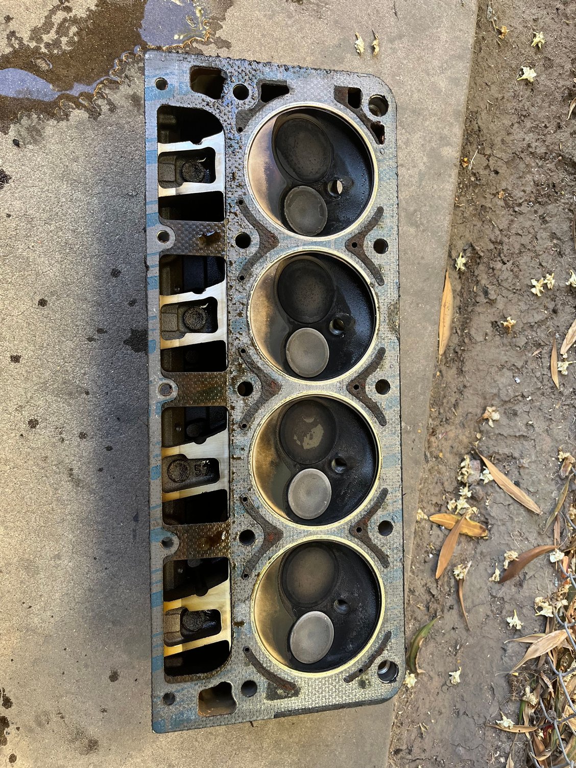

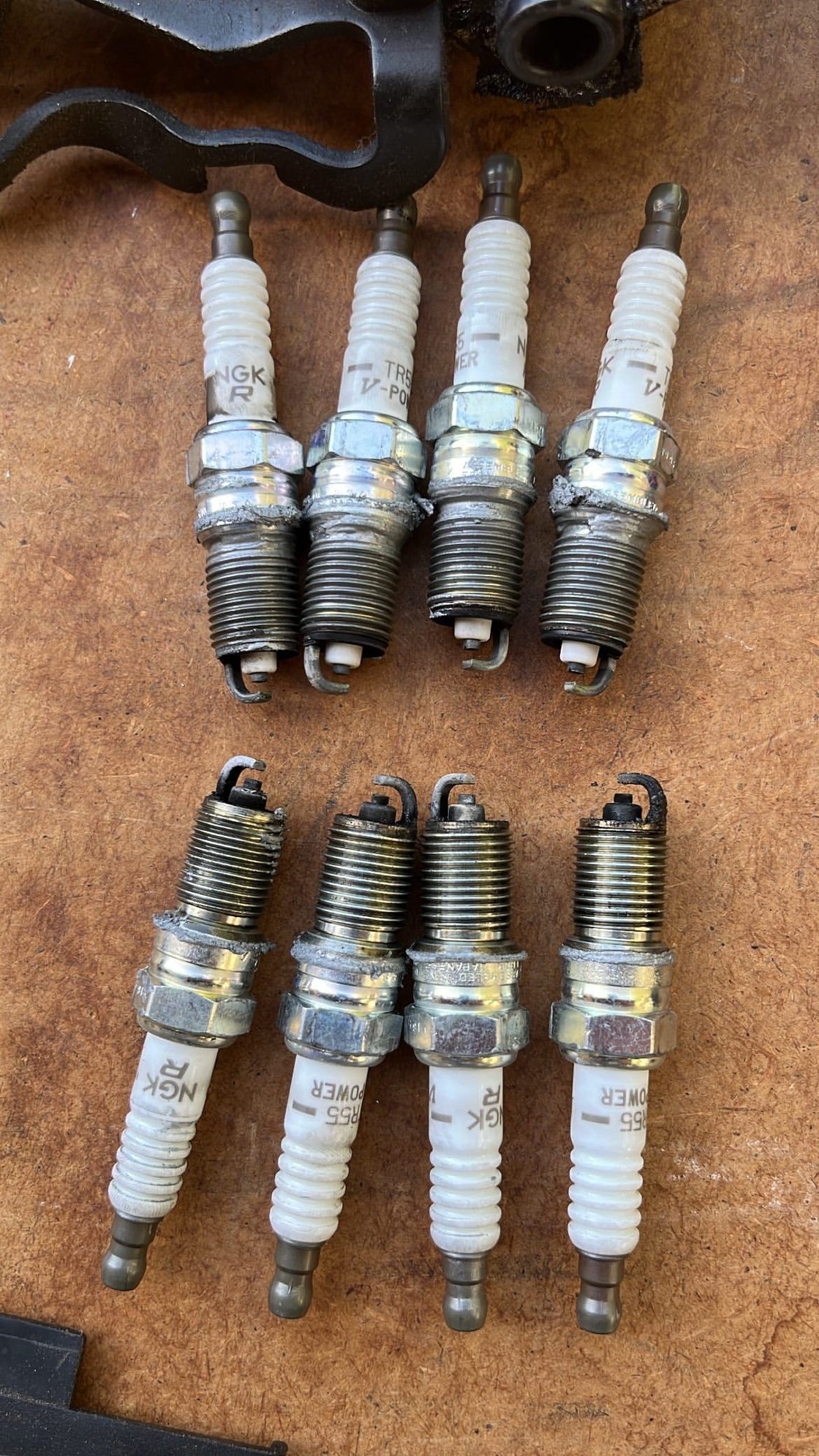

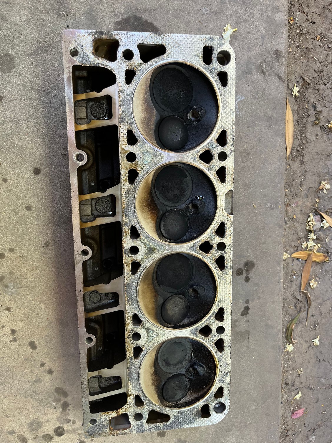

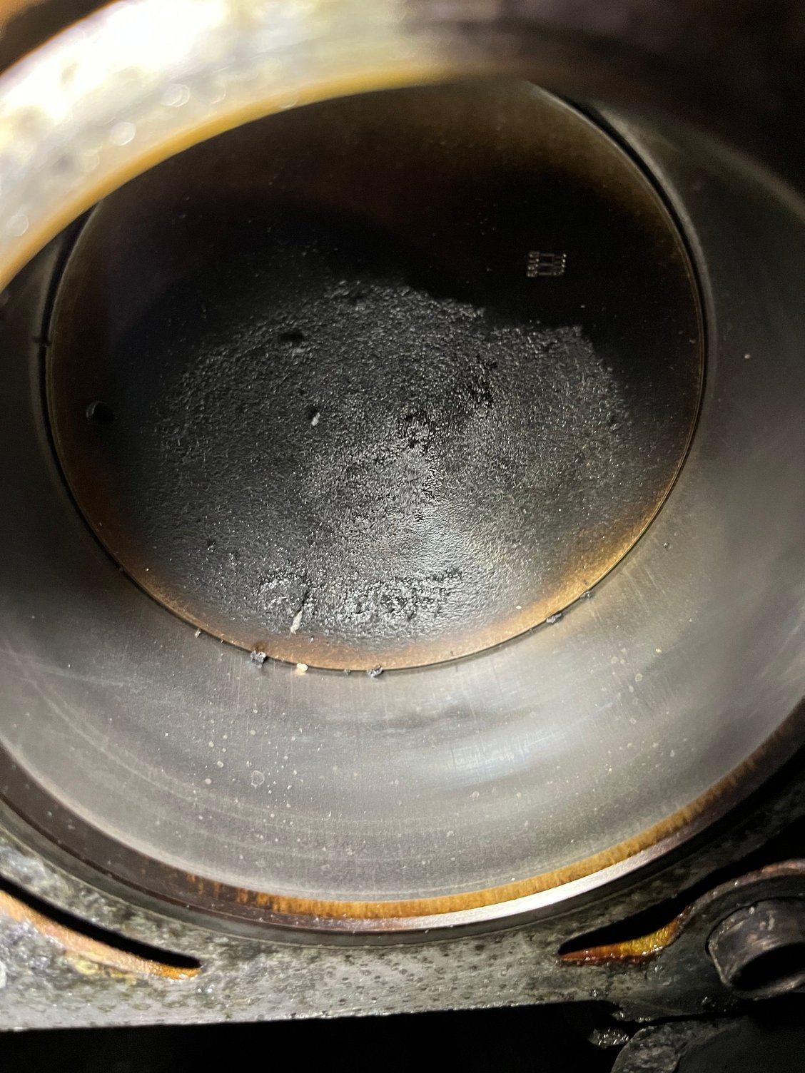

Pulled heads on my ls1 with 250k mi. Pass head was clean as well as the plugs and drivers side head was covered in carbon and so we’re the plugs after about 300mi, car smokes extremely bad at wot and burns 1qt every 150mi but the power still feels there. Compression on that side was 160-178 leakdown showed valves were leaking and no major signs with rings. With the heads off passenger side cylinder walls still have clear crosshatchings and look perfect and all drivers side are scored, lightly but still scored. Gas mileage has recently dropped from 15 to 10 mpg after a stall with stock heads and cam which seems excessive. I’m wondering if the cylinders could possibly be washed from injectors, but more importantly what would cause one side to be scored but the other side be perfect?? Scores are light and can’t be felt with a fingernail.

Not clear on the 'after 300 miles' comment. Are you saying the plugs are carboned up in 300 miles? Anyway, I think youve answered you're own question. In a 1/4 million miles, everything is going to wear!! Including the injectors. Since the drivers side has way more carbon, and your fuel mileage dropped considerably, I'd say the drivers side injectors are having issues supplying the correct amount of fuel. I agree you may be washing the cylinders, and it probably has been doing so for many miles. It's finally reached a point where it's noticeable in your fuel mileage. As for the scoring......RUN IT!! That motor has the right to show a bit of wear in 250,000 miles!!!
yes the plugs looked like that after 300 miles. I was thinking of getting the injectors flow tested to see if there’s something wrong with them. My main concern is the oil consumption. If it’s a mixture of the heads and injectors that are causing it to burn oil and drink gas then I might as-well just slap new heads and injectors on, however I don’t want to go through that just for it to be the same as before. You think the rings and scoring would be causing that much smoke?

Dint forget that the O2 sensor may be old, or bad, on the bank rhat has the scoring and excessive carbon. This may not be a mechanical problem but more so a bad O2 causing an overly rich fueling situation on that bank.

that’s a possibility but then I still have the oil consumption issue which fueling wouldn’t necessarily explain.

It would explain the oil usage because given a long enough period of time of the cylinder walls being washed down by excessive fuel would prematurely wear down the piston rings on that bank.... It's all tied back (IMO) to excessive fueling on that one bank. Someone mentioned this car having 250K miles... Is it still running on the original O2 sensors?

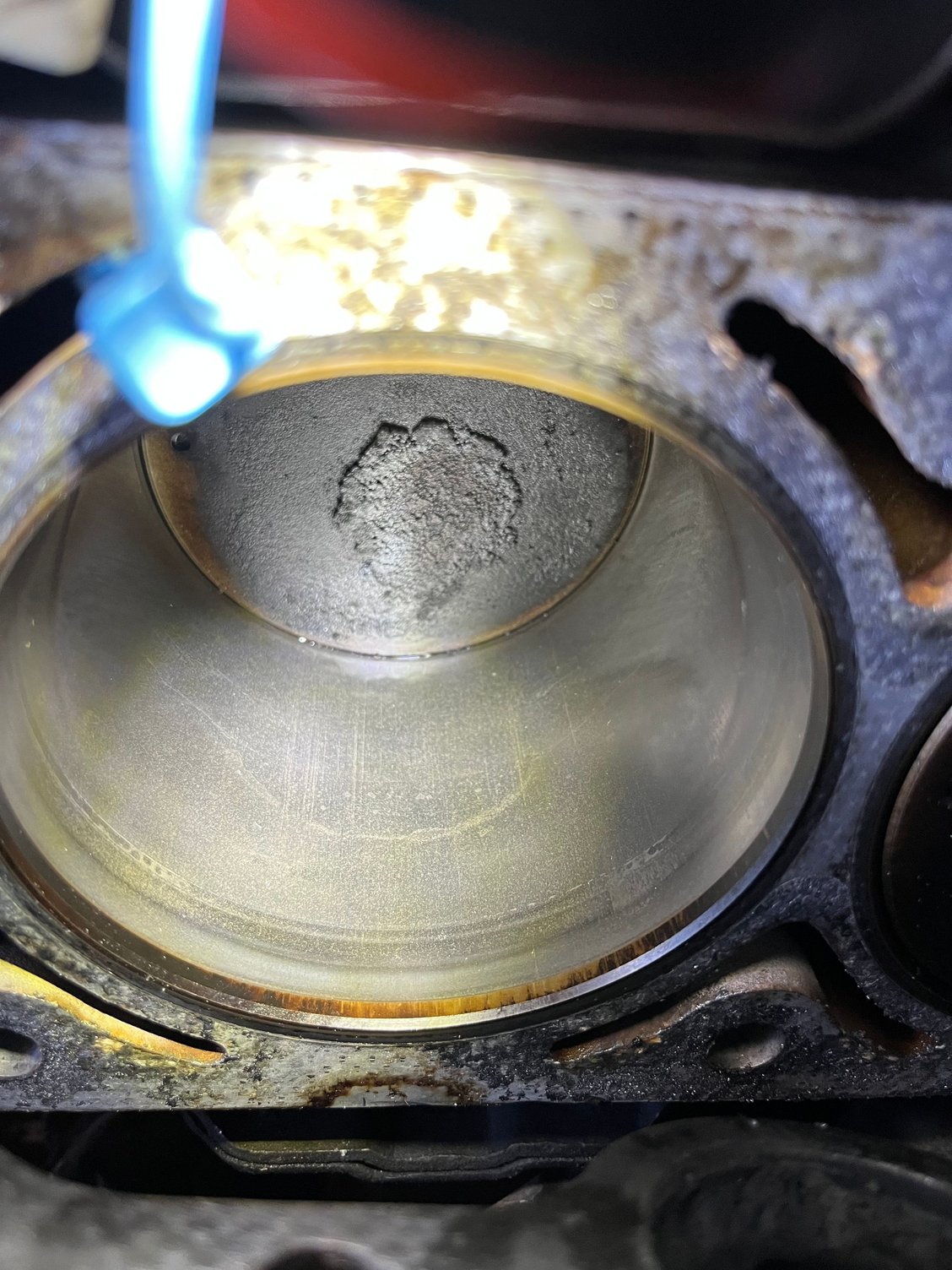

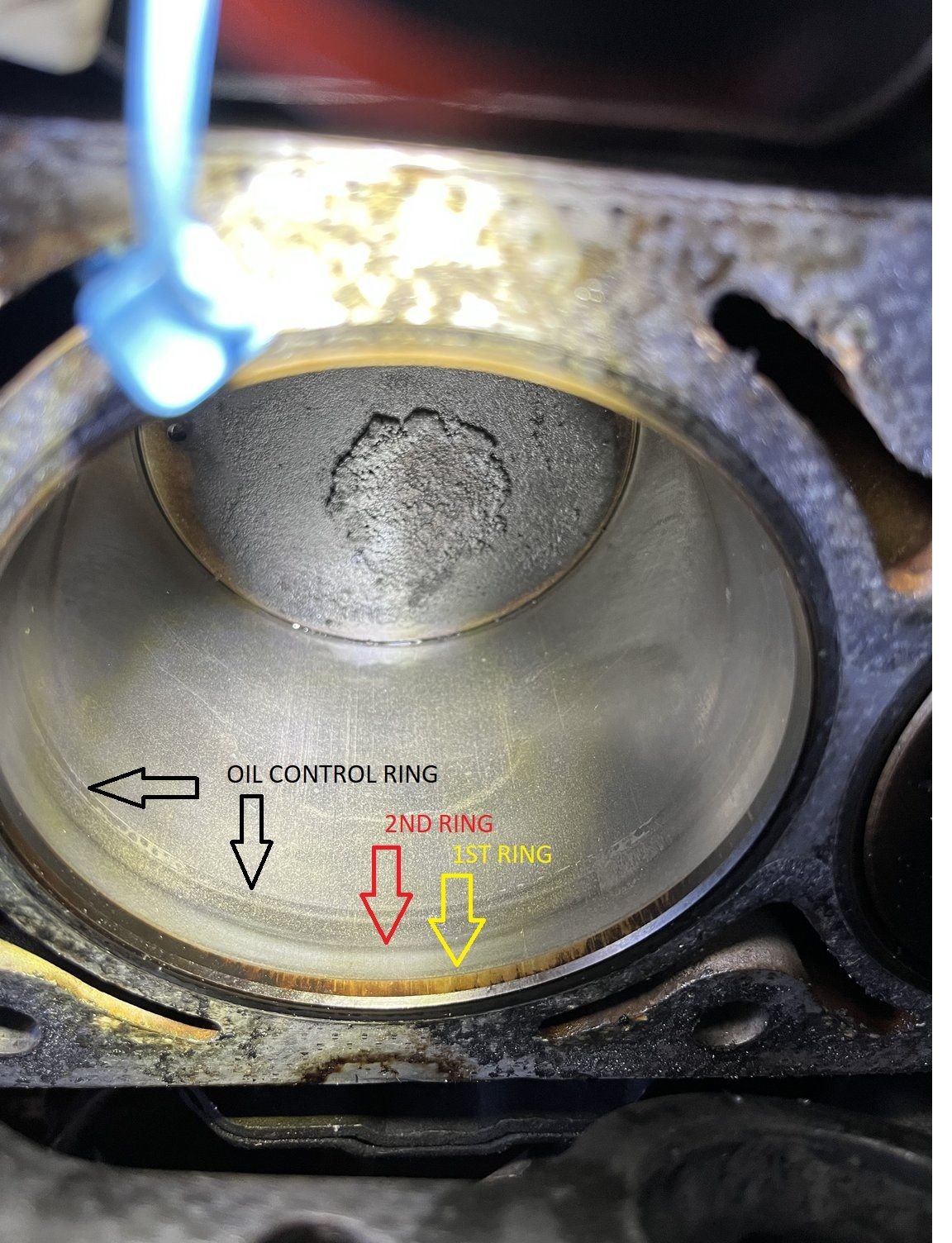

Your cylinder walls are in poor shape. It looks like the rings etched into the top of the cylinder. As I mentioned in your other thread, Run a 320 Ball hone through the cylinder to clean them up.

Does that etching occur as the rod is "rolling over" to the point where it is about to then start pulling the piston back down into the bore? It seems the rod "rolling over" (for lack of better wording) could induce a little wobble into the piston head and cause the etching. I'm just curious about this as I've never seen that type of ring damage at the top of a cylinder before. I've seen the ring it leaves at the top of the cylinder where the rings don't get up to... But never etched in witness marks from the rings themselves. Very neat that you caught that in the pictures. You have a sharp eye.
Correct me if I'm wrong, but is that oil in the cylinder? I see what looks like a golden liquid that is streaking down the cylinder walls. If that is the case, the rings have left the building and that clearly is his oil consumption problem, and lack of power, and carboned up components.

It's hard to say for sure but it could be moisture getting into the cylinder when it sits for long periods of time.

As for the scoring, no. That's a lot of smoke. I think your rings are junk...... I'll also add, regardless of LS1, or LS ANYTHING going 300,000, 400,000, 500,000+ miles, there's absolutely no way that those engines are producing the same power level they did at 25,000-75,000 miles. Period. IMHO, at 250,000 miles, ANY engine could use a rebuild.....

Well clearly you're beyond the poiint of running a leakdown and you never answered my question in the related thread linked below.

You also have to take into account that engine ring wear is typically the same accross all the cylinders and OP is only having a problem on the one bank which tends to make me think it could be just an issue with that cylinder head but there's the possibility that this could be the results of ring wash on that bank due to the ECM over fueling that side from a faulty 02 sensor that never got replaced and the owner just kept on driving it and can also be that the oil control rings are caked up but it's just too risky to put it all back together only to find out that it's the rings and your back to taking it apart. The engine doesn't owe you anything, it has provided many years of service so if it was me I'd be tearing it all back down and doing a rebuild.
