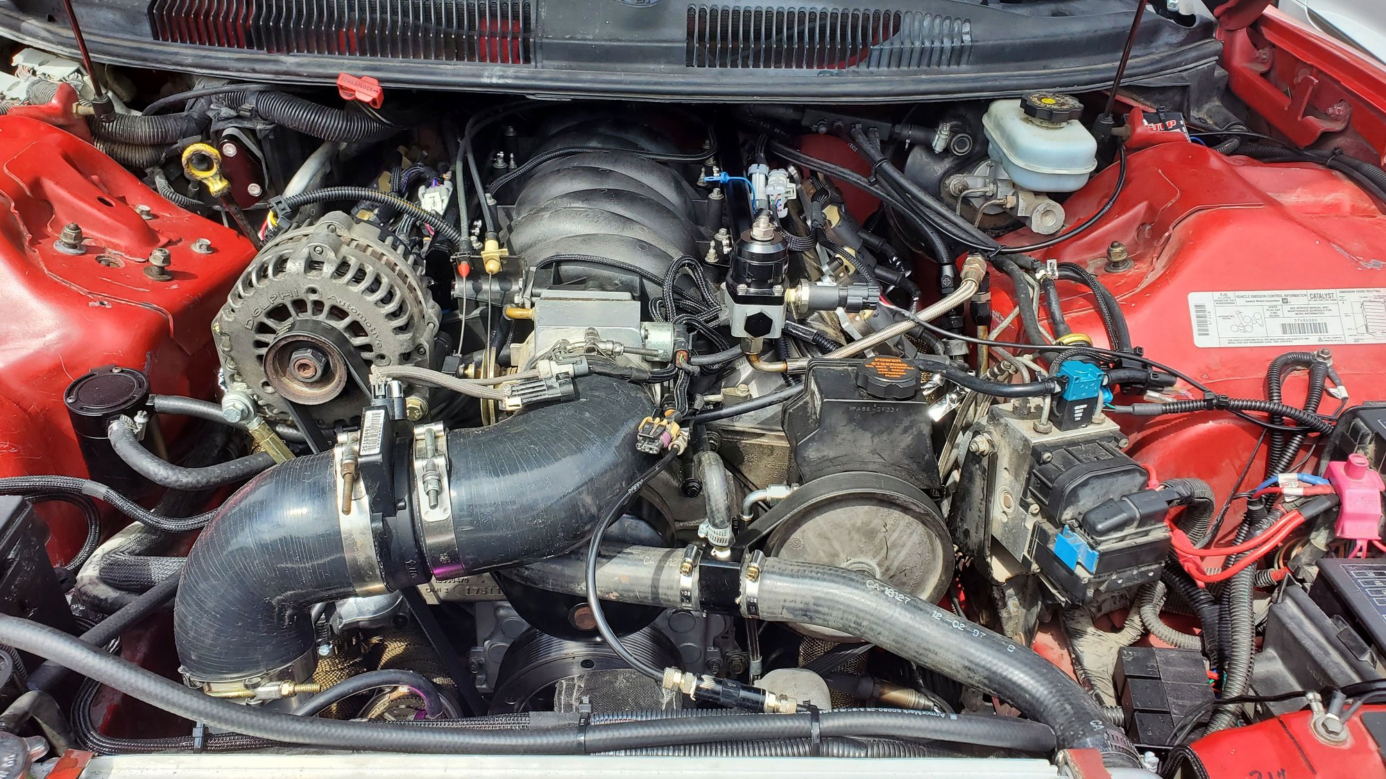

We have ignition!!

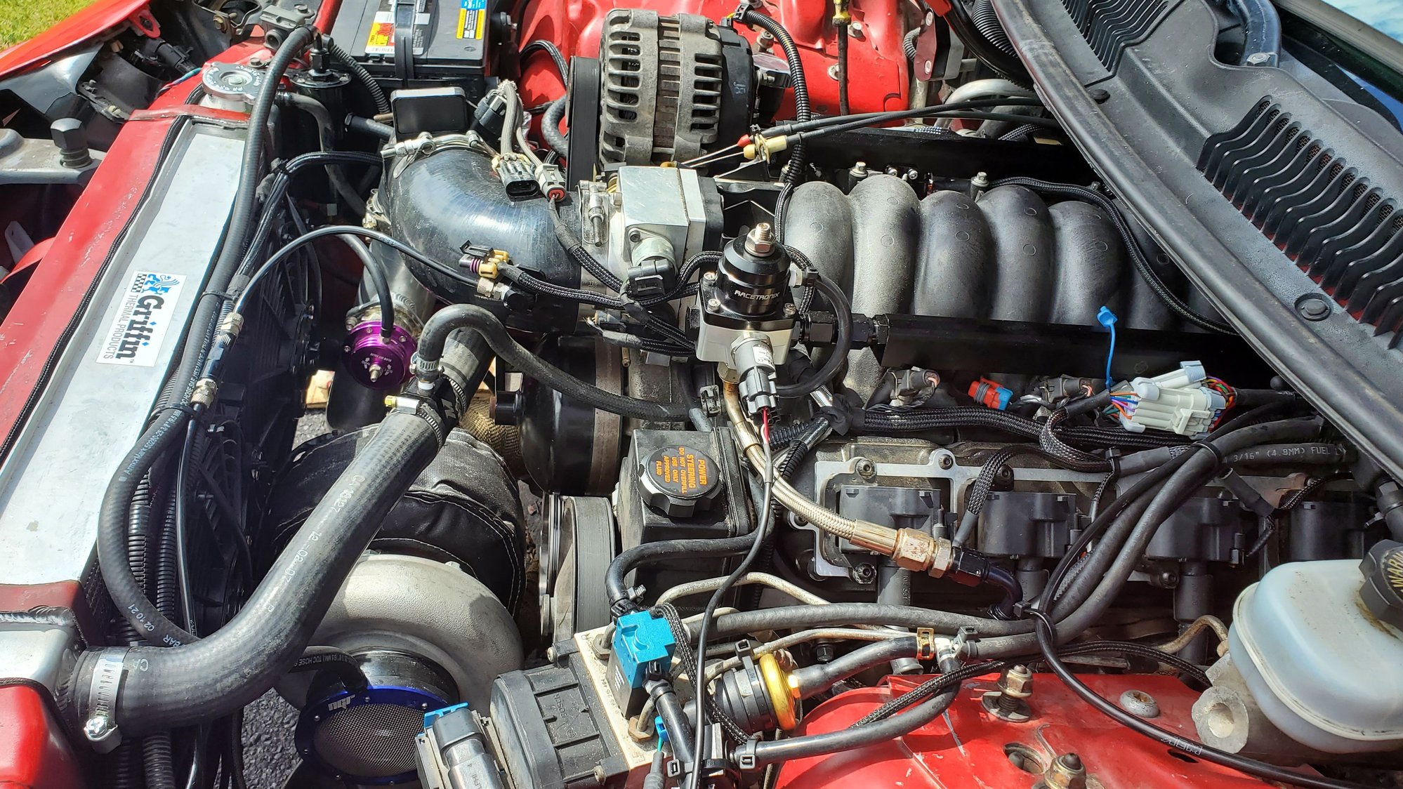

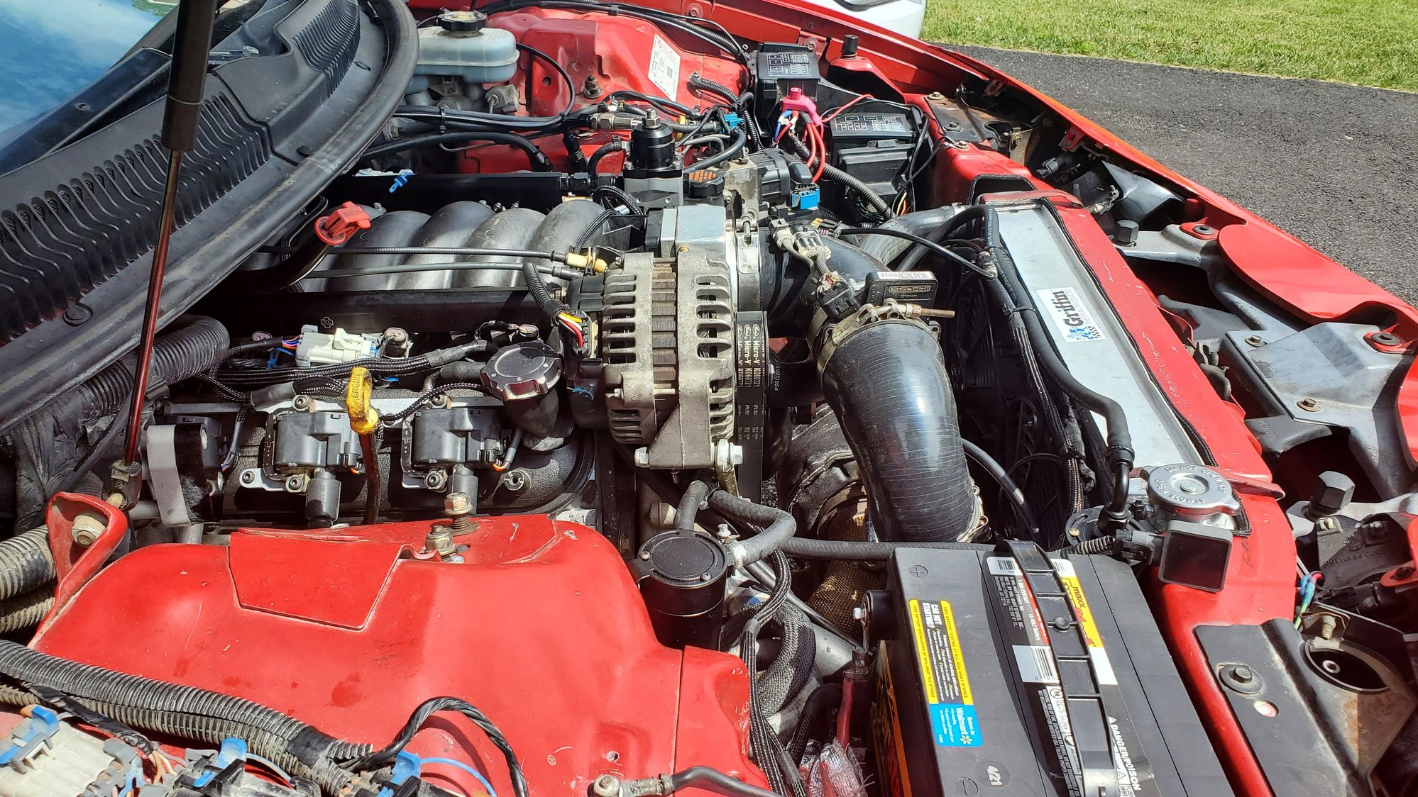

All buttoned up and fired up. doing a shake down and checking for any leaks. had a slight leak on the fuel return i tightened up. i hate new wraps lol all the smoke burning off the manufacturing chemicals make me nervous as hell lol
I'm suprised it actually started and started idling on it own before I even loaded inital idle and injector data tune.
I can definetly tell it's got a bit different sound to it. I love it already can't wait to run it on the street.
One buttoned up ls1 with a stage 2 turbo cam
small methanol tank with pump hidden
pretty tidy compares to what i startes with lol
now to do some beautification later

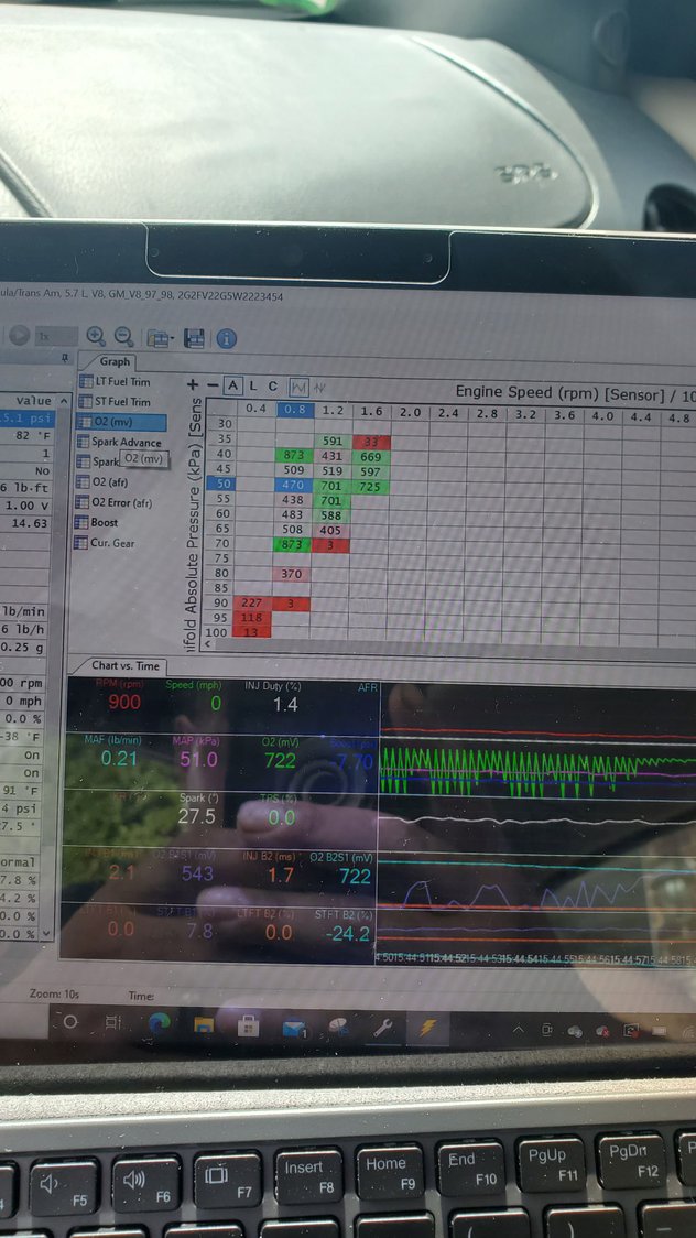

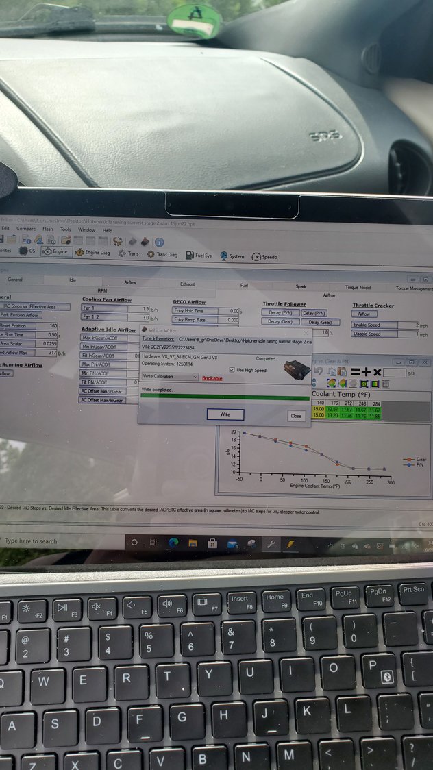

started scanning and idle tuning

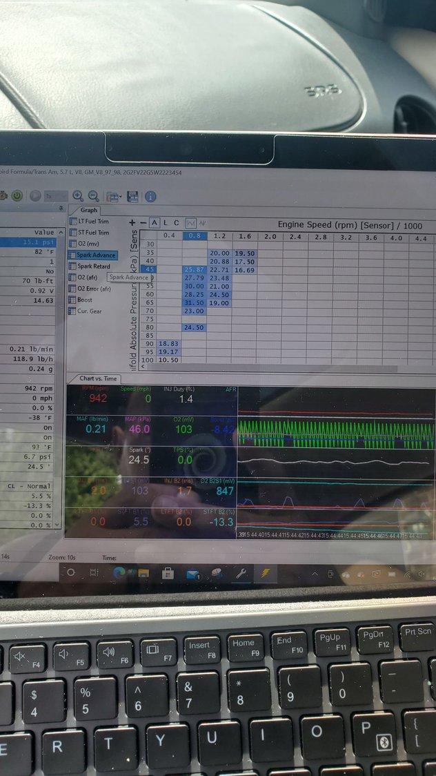

checking out some inital idel data

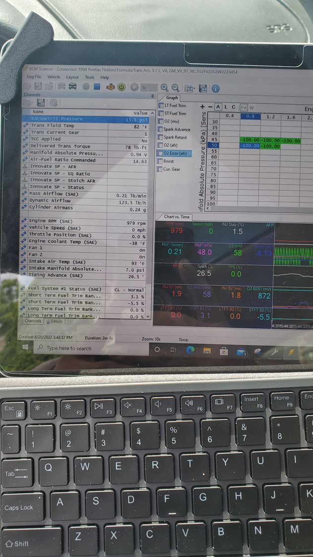

trying tobfigure out my VE table. not sure why its at -100, but if i muktiply the table bybhalf, i go from 12afr to 18afr to try and clean it up, but when the VE is in the 18afr range for idle it runs alot smoother, but at 12afr at idle it is a bit hesitant and it is super rich lol got my work cut out for me.
here the inital scan. not too bad for running without a tune for the injectors or even the new cam
how im scanning the new cam

ironing out the idle. sounds much better now that I figured out why my afr and water temp wasn't reading correctly. Apparently 98 ls1 had the same plug in for the TPS and water temp sensor. I figured that but when for some reason my water temp was -38 and both fans were running from the start, but then noticed my tps channel wasn't recording anything thing... so at first I thought my sensors might be going bad, but then noticed that both plugs are the same... this explains the strange -100 afr error recording. well, swapped the plugs and low and behold recording properly and was even able to watch the engine get up to operating temp and turn on fans at 185 and 195. also got normal looking afr error data now lol
if you have a 98 ls1, they used a 3 prone plug that is exacly like the water temp sensor. If you have the mentioned errors like i did initally, then you might have accidently mixed up the plug. if your any other ls, its a two prong.
