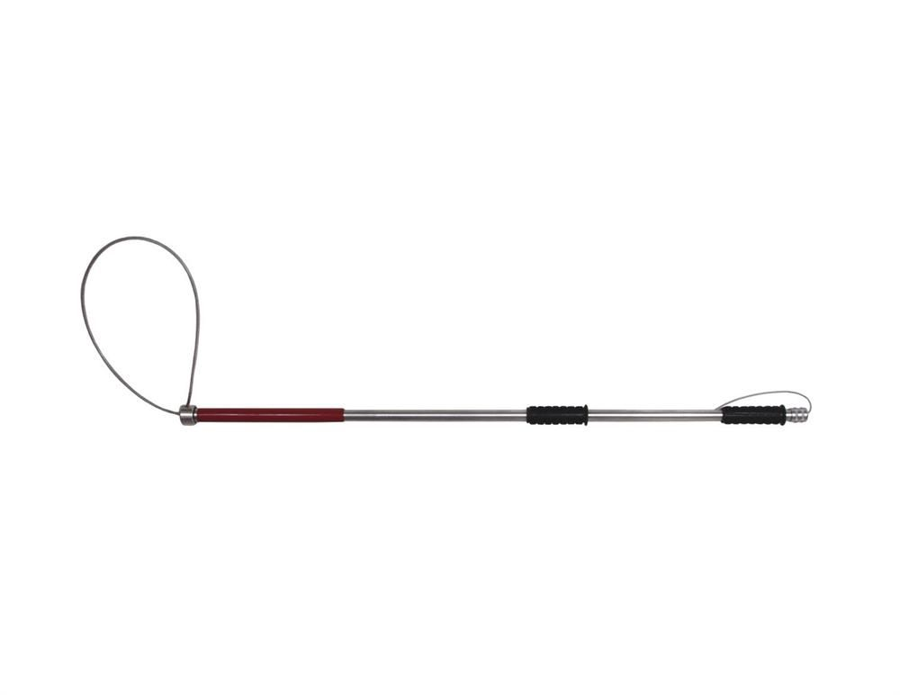

If you can see or get to the end of the straw, build something like one of those animal control poles, loop on the end that you can tighten and grip the straw good and hard.
