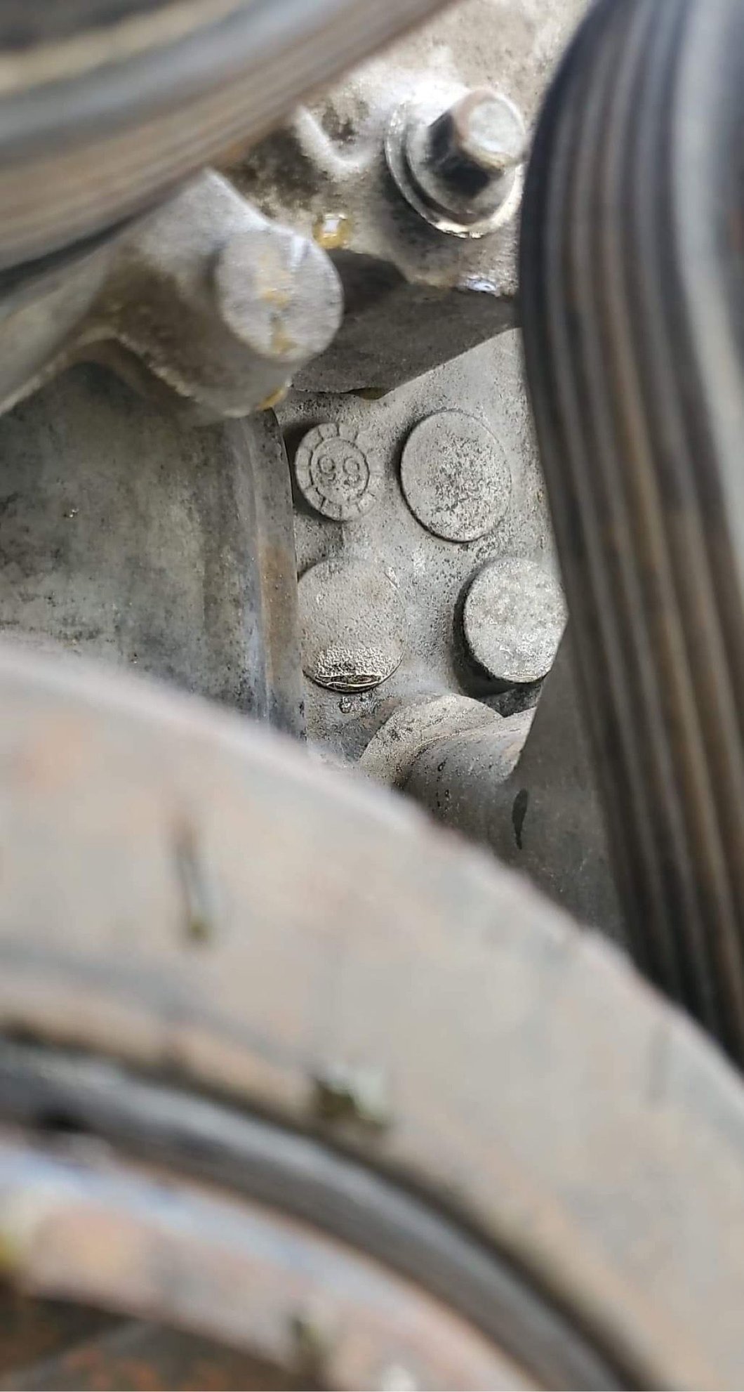

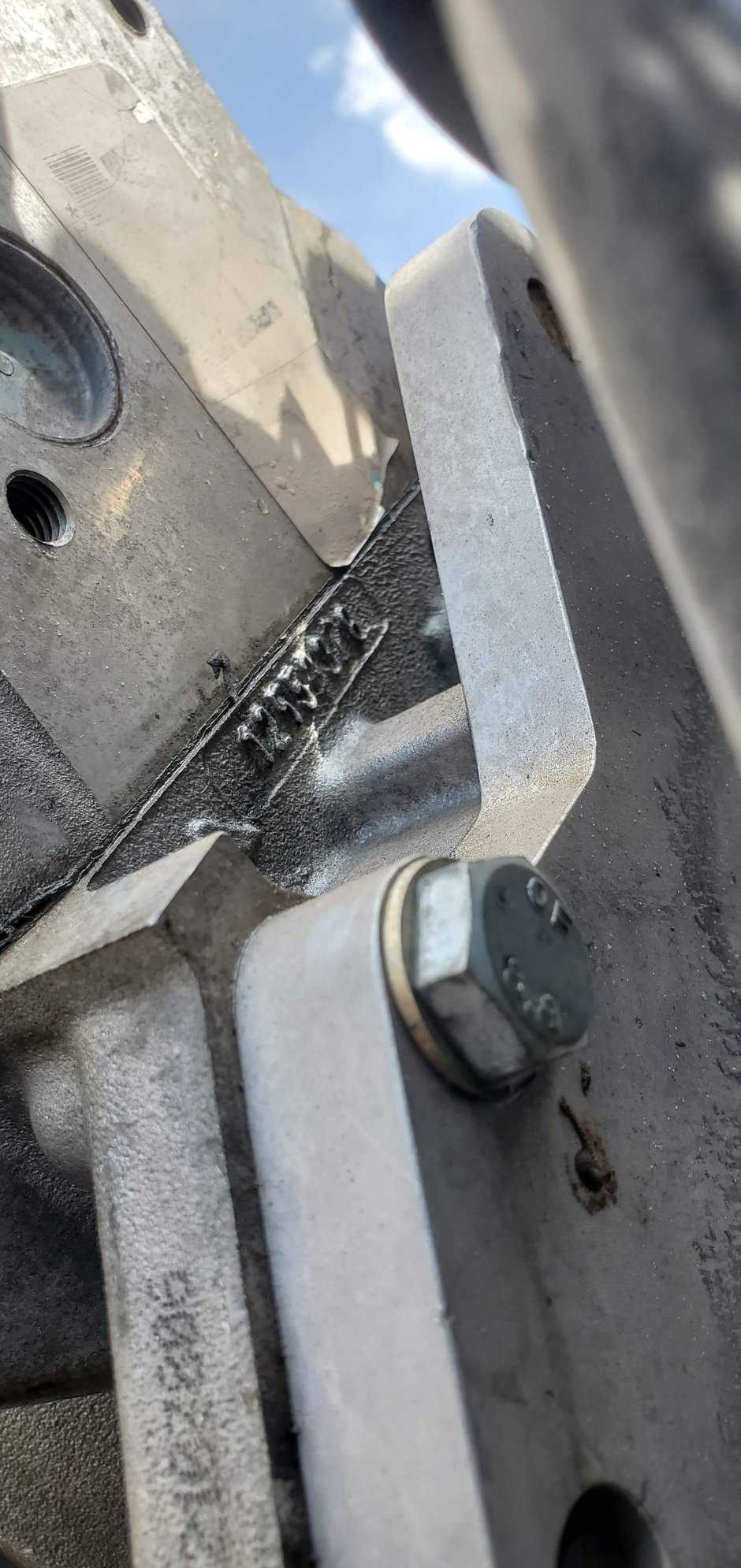

Post a pic of the stamping number please.
Old Aug 2, 2022 | 05:56 PM
VanBullet's Avatar
Joined: Apr 2022
Posts: 31
Old Aug 2, 2022 | 05:57 PM
Posts: 22,308
Likes: 3,625
If it's scarred up, it's a safe bet .005 won't do the job. You might find an aluminum 5.3 block and bore it to 5.7 size. That is doable..
Old Aug 2, 2022 | 05:59 PM
Posts: 7,855
Likes: 5,206
Show us the block number also please. I have never seen a block with that number.

Old Aug 2, 2022 | 06:01 PM
VanBullet's Avatar
Joined: Apr 2022
Posts: 31
