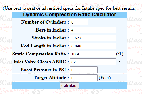

Hey odd question about this setup. With that kind of compression in an LQ9 the Ghost cam would put the dynamic compression ratio way over 9:1. I ran into a similar problem with my LQ9 with 243 heads (10.9:1 static compression) and the Summit stage 2 cam. My dynamic compression was 9.2:1 because of the 43 deg ABDC. In my combo I had to run E85 or I got lots of detonation.
How are you getting your values? The DCR is calculated using advertised. And if I use your 10.9:1 value I get:
I used this calculator https://www.uempistons.com/p-27-comp...tio-calculator
It says to use .050 + 15 deg.
I got the exact same numbers from this one https://www.gofastmath.com/compressi...tio-calculator
It also uses .050 numbers.
I would love it if I was doing something wrong to calculate this. That would mean I just need to figure out what in my tune is causing detonation. But every calculator I use tells me the same thing.
DCR can really only be calculated using advertised, not 0.050" values. They are trying to estimate advertised by adding to the .050" however if it's only adding 15* to closing then it's approximating the advertised is only 30* more than .050" value. Most aftermarket cams are more like 50 to 55* increase duration @ .006" which means you really need to add 25 to 27.5 to approximate.
Wallace Racing allows you to input the advertised directly IVC, which is provided on Summit's Cam Cards. http://www.wallaceracing.com/dynamic-cr.php
Thank you so much for this. This helped me out a lot. I had no idea. I have been looking at DCR using the .050 numbers for a long time now.

thanks for brining up that question about dynamic compression, mine is coming out to 8.98:1 if I plugged everything in correctly.
The 8715r1 cam actually bleeds off more compression than the smaller cam I was originally leaning towards.
How high in dynamic compression can you go on 93 octane? When does it start getting to high?
