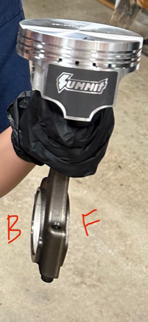

When I disassembled my '99 LM7, all rods were facing the same direction. Check out the area where the rod bolt goes through. The front side has a flat and the rear side has a rounded edge. I'm gonna dig up a picture to post later.

Default '99 LM7 rod

Beautiful! Thank you very much!
