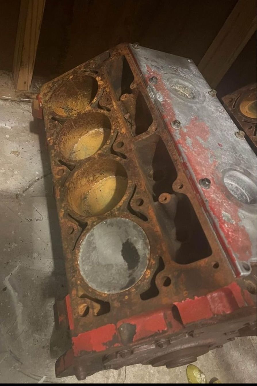

I found a 6.0 lq9 but has some rust to it. Do you think it can be saved Or worth saving?, can get it for a few hundred Here's a picture of it

Looks pretty grungy. Only way to know is to see how much machining cleans up the decks and bores, but then you have machining costs whether or not it is junk.
Tough call, but I would pass. There are far cleaner engines out there....

Lifter bores likely look just as bad, which means having to step up in lifter size too for more $. Or bushed bores which is still $. Even if free you’ll end up paying more in the end for labor.

LQ9s in GOOD shape aren't that hard to come by. Pass.
I wouldn't take that for free, personally. Youd have to pay me enough for me to pay somebody else to haul it off, plus some boot for wasting my time.

Looks bad..It's really hard to say if it will clean up with a bore. Does it even turn over?

SHEEEESH! Was it soaking in Salt water?? My biggest concern wouldn't be the cylinder bores, unless they're already bored oversize. My concern would be the lifter bores, bearing saddles and main caps.......

Might be brought back if soaked in a tub of Evaporust

If you have a shop that still has a real hot tank system (Dip) you could strip it and have it soaked, it will take all the rust off, and youll see what you have left but its at least 100 bucks to do if you have it all prepped, can go as high as 200 pretty easy. As mentioned, every machined surface on the block will need attention most likely.

Even if I got that block for free & still worked at a machine shop to do all the work myself...I still wouldn't mess with it. I 3rd the vote...OVERBOARD!!!
