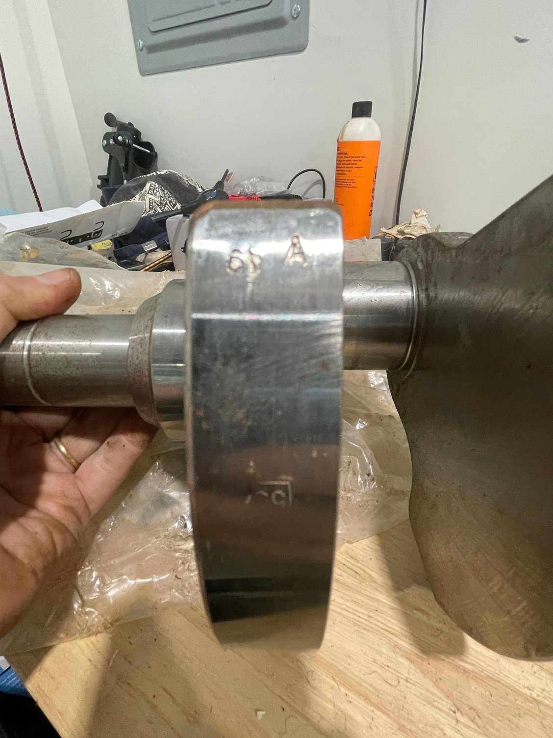

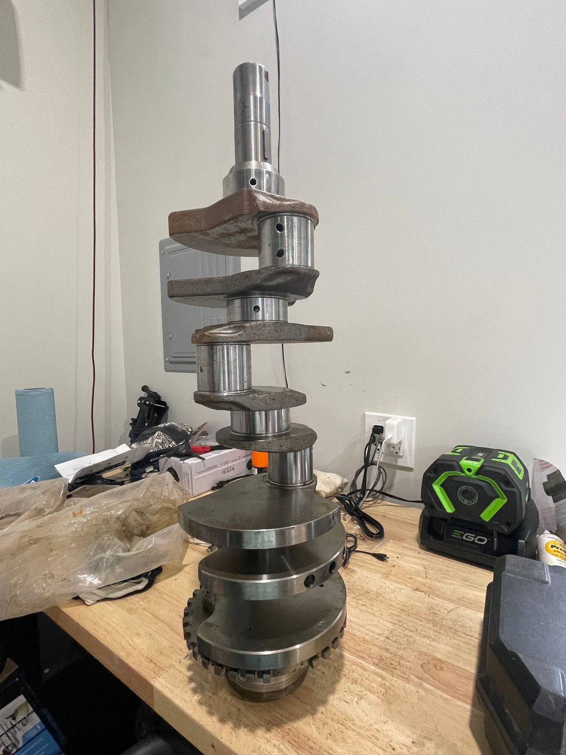

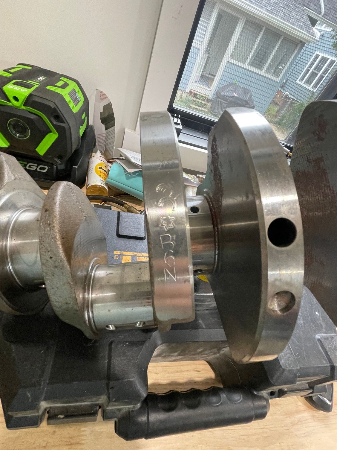

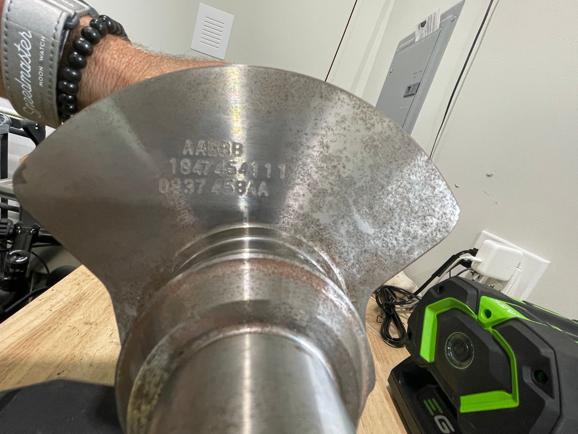

Hello Everyone,
I’m not a Chevy guy…my dad was. Anyway, I’ve got this crank that was with a LS block. The block is gone, but still have the crankshaft. I think it’s an LSA crankshaft. Got some Stamping on it. Can anyone shed a bit of light?

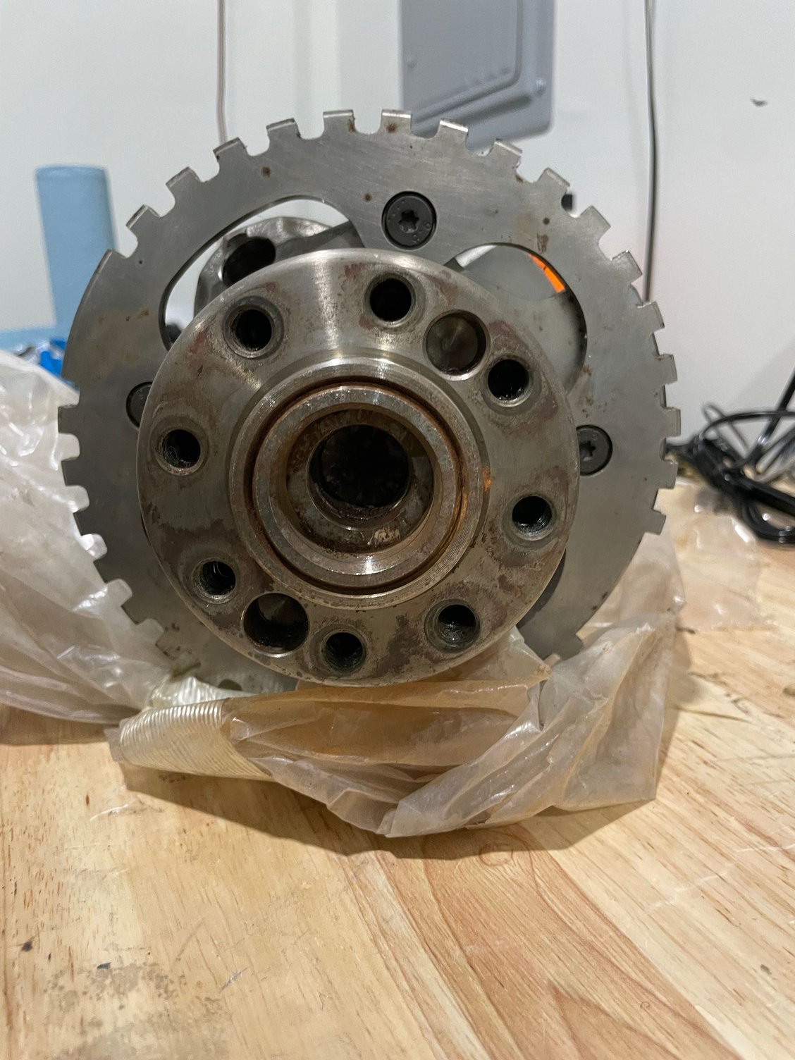

That’s an aftermarket crank. Not sure who’s but lsa cranks have a purple/gold/iridescent hue to them. Also the reluctor is pressed on, not bolted on as yours is.

That reluctor tooth count and spacing is funky too.

Quick internet search for 8 bolt flange and 32x brings up 4.7 and 5.7 (hemi) dodge. Its reluctor bolts on just the same as this one.

Looks like 5.7 or 6.1 crank for a hemi? 32 count reluctor?
