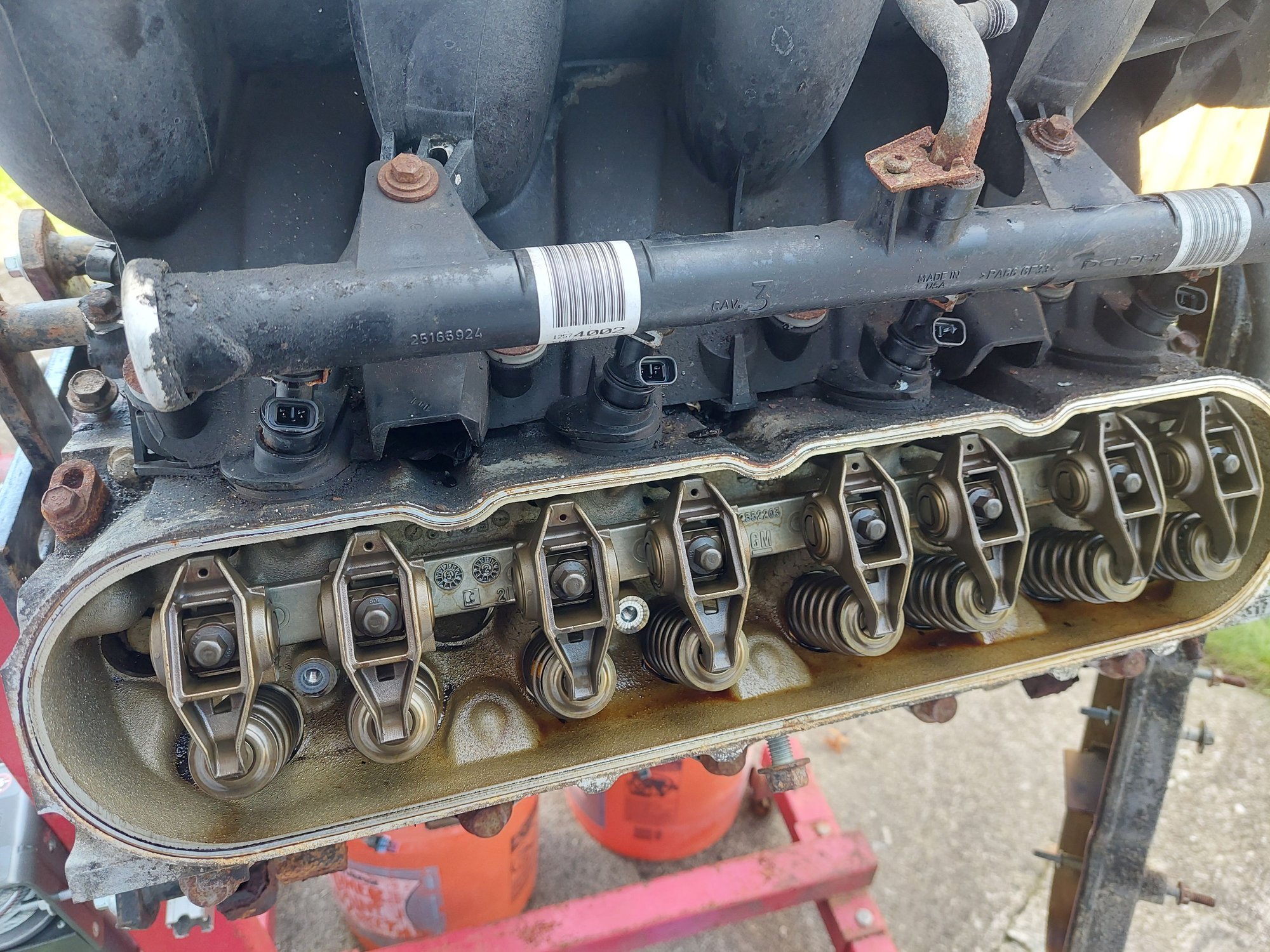

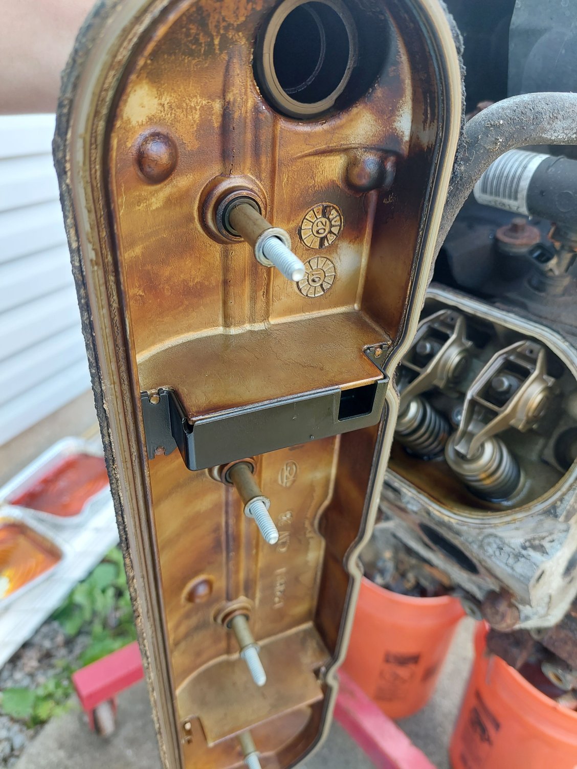

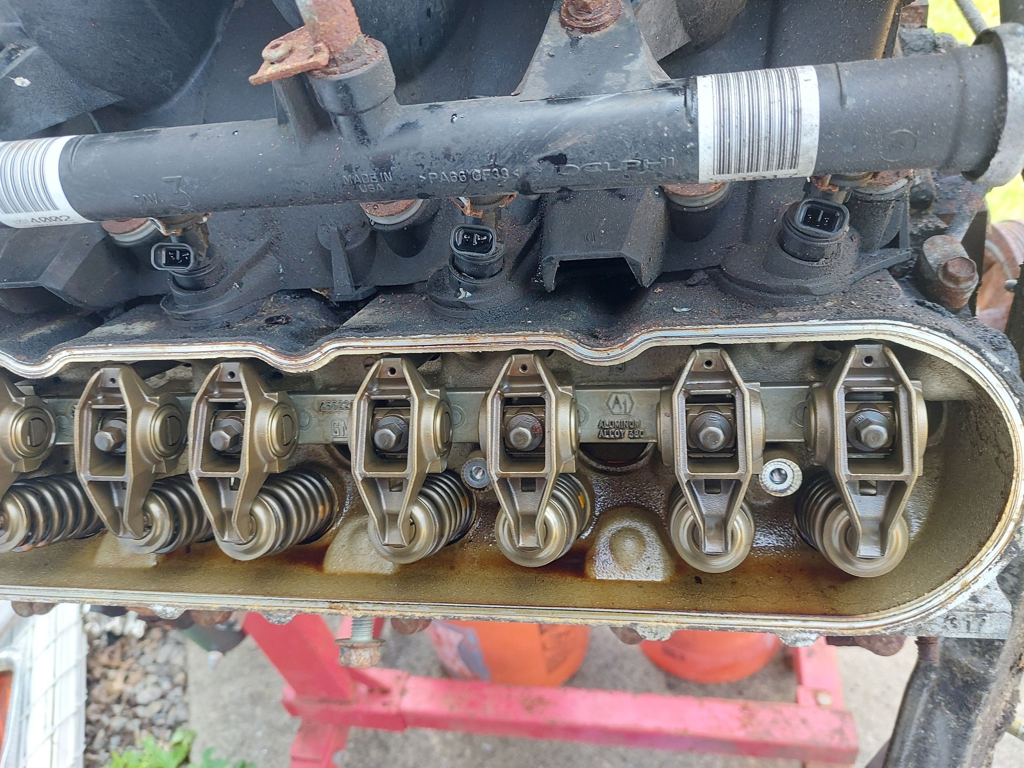

I feel as though the heads and valve covers look quite clean for the mileage, which seems promising to me as well(photos attached).

It looks clean. Front and rear seals are always a good idea while the engine is out. Don’t remove the covers, just pop the seals out with a pick or screwdriver and light hammer, and replace the seals. Removing the covers will lead to alignment issues (and oil leaks) if your not very familiar with how the covers line back up.
Pull the oil pan and have a look. While your there, it’s easy enough to remove the windage tray, and pull a rod and main cap to look at bearings. At 160k, I’d bet they are minty with an engine that clean.

Don't take it any apart any further it's fine. You're spending a lot of money on a transmission to fix a car that probably should never have been taken apart in the first place. Man, this hobby gives me a real headache
Anyways, I like what you're doing. I like it a lot. I like that you're fixing a car that somebody tried to kill. Anyway, that's wonderful. Bottom line if that were me I would do the oil pump o-ring, valve springs, valve hat seals underneath the valve springs of course, and a new timing chain, even though it's probably fine as the LQ9s generally have a heavier LS2 stall one on them already. That's it. I'd be done. I leave the stock cam in there for now and get your swap put together with that nice, smooth bigger engine in there.
What's the rear end on the car look like? I'd certainly be looking there first before doing a camshaft on the engine. You had a 5-7 before. This is a 6.0. it's not an enormous difference, but it's going to be a nice difference and with the six-speed you're going to be expelling a lot of torque to those rear wheels people hate to admit how they regret being able to Putt around lugging the engine in the lower gears The way you can with the stock cam. Give it a shot for a while while you sort out the rest of your swap You might like it

If it doesn't leak don't touch it. That's my opinion from doing several of these motors. It looks very healthy from the valve covers. It ran this way in the previous vehicle, so it will run in yours. As stocka4 said, I would just shove it in the car stock and make sure the bottom end isn't blown out before you dump hundreds(maybe thousands) into the top end with cam, lifters, heads. Get it going first, then upgrade. Most importantly have fun.
