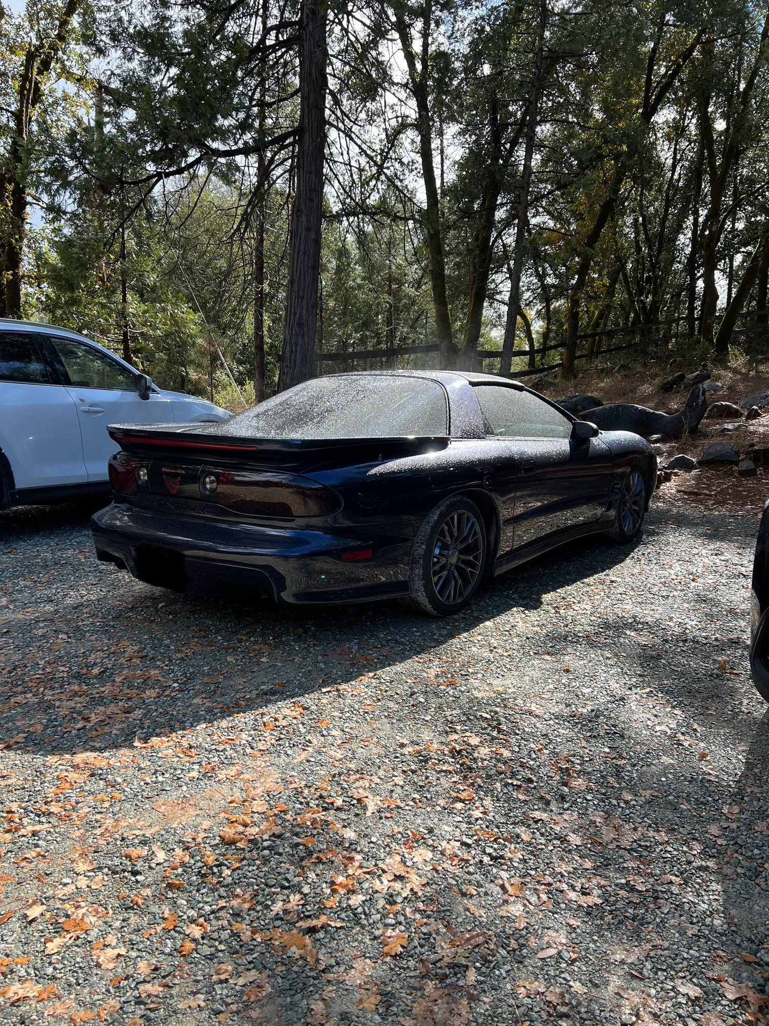

I am going with 3.73, stock SLP exhaust I plan on doing headers with full exhaust this summer once I leave CA. I agree with what you said, my main priority is keeping the ole bird running. I've read that the stock ls1 spring are prone to fatigue (I have 58koriginal miles) so I was thinking about replacing them along with the valve seals. Thats how I started down the "You should use ls6 spring and while you are at it do the 243 heads!" rabbit hole. If the ls6 cam is lacking in city drivability then I'll stick with the ls1 cam. Low end torque is my friend.
