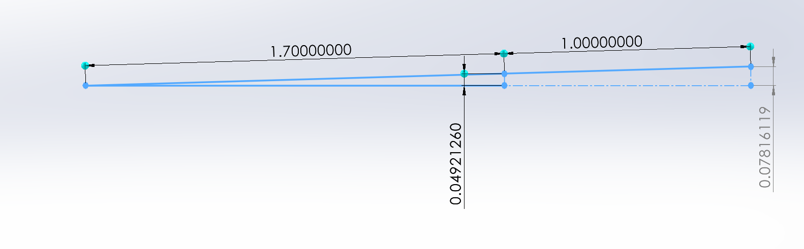

M8 x 1.25 is metric, each thread is 1.25mm apart, like the image. 1.25mm to inches is 0.0492126in. So, one turn will move the bolt down one thread, or 0.0492126 inches.

For anyone looking at this thread for help in the future, this will only work for 1.7 rocker arms, here is how I did it:
To find the lifter preload with a known length pushrod, find zero lash, then count the turns of the rocker bolt it takes to get to 22 ftlb, then multiply the turns by 0.078161". That will give you the preload with the pushrod. Take that number and subtract it from the pushrod length you used, and it will give you the pushrod length before preload. Then add the recommended preload for your lifters, and you have your pushrod length.
I recommend not rounding any numbers until you go to buy pushrods, you'll lose a few thou, and that's not ideal. And when it comes to buying the X.400" vs the X.390" you want the closest you can find.
Here is a drawing I made of the rocker arm, as the rocker arm is a ratio, the exact lengths of both sides do not matter.
