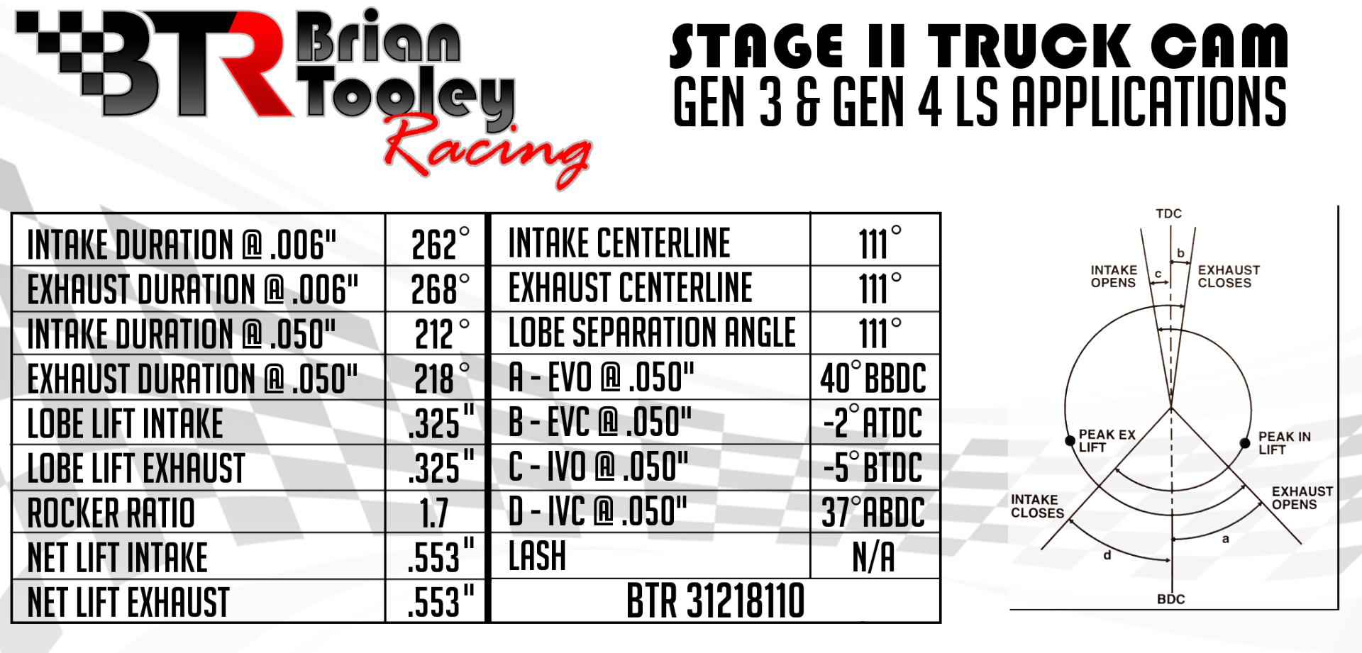

Hello all. I would like an opinion on which heads to run on my build, I have a set of 243's and a set of 317's. I'm building a mild 6.0 for a 1978 Chevy 2wd truck that will never be raced. It will be more for show and cruising around than for performance but I do want to hear the cam at idle. It will be .030 over bored with sealed power flat top pistons (I believe that's factory LQ9). I'm leaning towards a BTR stage 2 Truck cam BTR31218110. The reason for my head decision is that I don't want too much compression for pump gas, which is all I'm ever going to run. I have no idea what my piston to deck, either in the hole or out will be until I get this thing together but I'm figuring to achieve around .035-.038 quench. I don't want to have to rely on high octane pump gas, especially not knowing what the future holds. I played around with compression calculators and it seems like I can get away with the 243's but I want some expert opinions, thanks much to all.

The BTR is a 62* IVC @ .006" which is earlier than a stock LS2 cam. Once you have the engine assembled and measured to accurately calculate with each head volume, then decide. <8:1 DCR, 87 octane is possible. >8:1 you'd want 91+ to be on the safe side.. If it's just a cruiser, there's no need to push the limit of a low octane fuel by trying to run high DCR, so just use whichever head matches which octane you plan to run.

Thanks 68. I've been using the online compression calculators and I'm getting around 10.64 static and 9.4 dynamic, which I think is prob something I'm doing wrong. I'm figuring 4.03 bore, 4.06 gasket, 3.622 stroke, 6.098 rod, 70 cc head. .050 thick gasket. -.01 deck (guess, since it's not together yet). Using the BTR 31218110 card. IVC @ .050 =37*
Am I figuring this wrong? This combination is a factory ls2 isn't it?

You cannot use .050" figures to calculate dynamic compression. The IVC will be too early, and if the valve is .050 off the seat, you aren't building compression anyway. 68Formula's .006 figure is correct in terms of being able to get really close on DCR.

Thanks for the reply. I did see where someone mentioned 62* at .006. I'm not seeing that on the card (attached). I don't have the cam yet, I found this on the internet. What am I missing?

Ok, I entered info into the Pat Kelly calculator and I now see the 62* adv intake closing angle. I come up with dynamic 8.65 and static 10.64. Can someone verify if this sounds correct? Thanks,

A lot of companies don't release their "advertised" numbers because they can vary wildly amongst different companies ( a 280* duration cam from one may be nothing like a 280* duration cam from another ) and since cylinder head flow below .050" is generally a moot point, they choose to show @.050" numbers so enthusiasts have an easier time choosing a cam. If you were to call BTR and tell them you were trying to compute DCR, I'm certain they will give you the info you need to do so.
