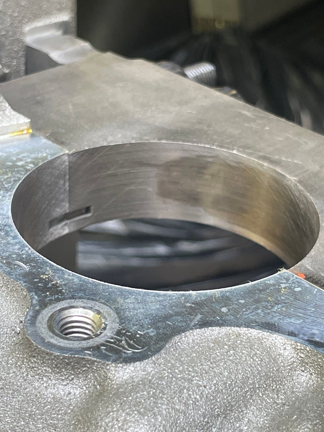

Lol. I have the mains honed on every aluminum LS build I do, with ARP main studs. Here’s a picture of the last one I had honed for ARP main studs. Pictures are worth a thousand words here…pic says it all. Find you another shop sir.

Anything can be machined, I work in a machine shop.
Take it somewhere else.

How are these supposed "machine shops" staying in business with the ridiculous amount of disinformation they put out? I don't know of any shops in California, but you definitely need to locate a different one.
