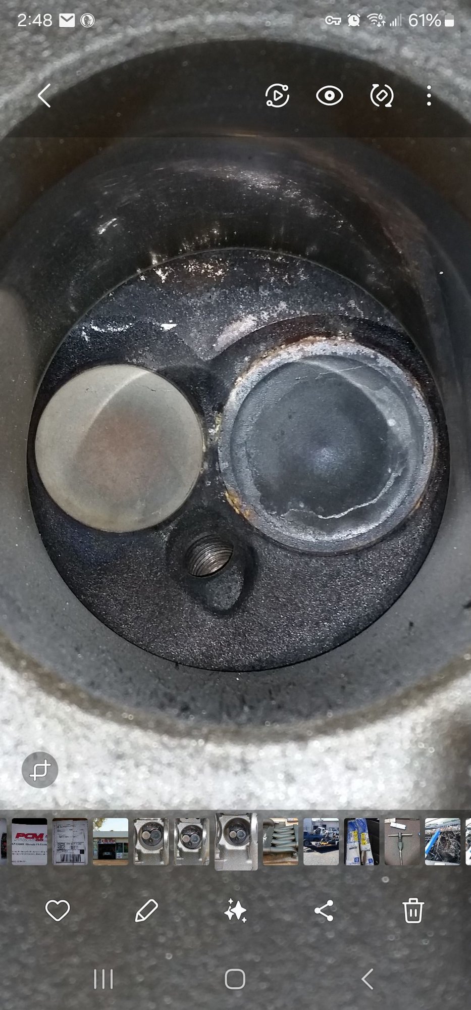

Old Jan 30, 2025 | 04:55 PM
  #54
1FastBrick's Avatar
iTrader: (16)
Posts: 9,750
Likes: 642
From: JunkYard
Here is a stock bore, iron 5.3L with a junk 317 head on it. I zoomed in on the original image and took a screenshot so we can better see the valve placement. This pile is still sitting as a mock up in my race car.

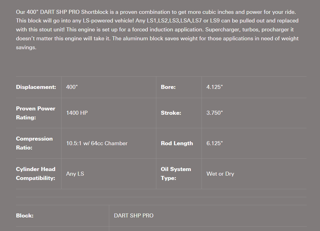

I still think for a 3800 lbs race weight and my power goals an aftermarket block with more cubic inches is the way to go. The 5.3 combo being discussed is probably amazing for a lighter car with a turbo. I really like the 400" short block LME sells here:
https://latemodelengines.com/product...pro-400-1400hp

400ci with the 3.750 stroke is another great option. Between it and a 388 I think you're splitting atoms as they are both big bore options and that would be just more of do you want to say you have 400 or 388ci. The selection for cranks with the 3.750 becomes a little bit narrower as well if you wanted something a bit stouter than the Compstar.
