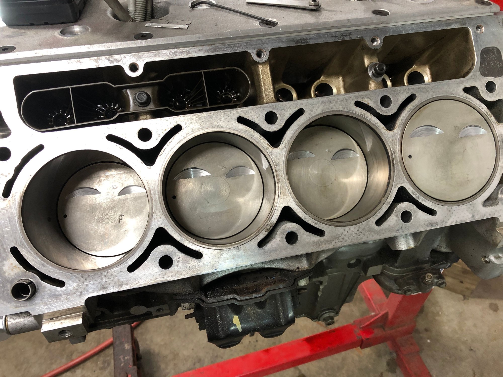

I currently run the BTR Stage 2 PDS cam on my stock headed LS1 with a TVS2300 and a 103TB. I feel like it's a lot of cam for that engine IMO. I actually had to fly cut my pistons because the PTV was very tight. If I could do it over I would have went with the stage 1 PDS.

I was also very surprised, had some back and forth discussions with BTR on it after I figured out how tight it was. If my memory serves me right, I had like .025" PTV on the intake and something like .040" on the exhaust. They were surprised to see it was that tight as well. We went over the cam timing and triple checked and that's what it came out to be so I notched the pistons about 0.100" just to be safe.
