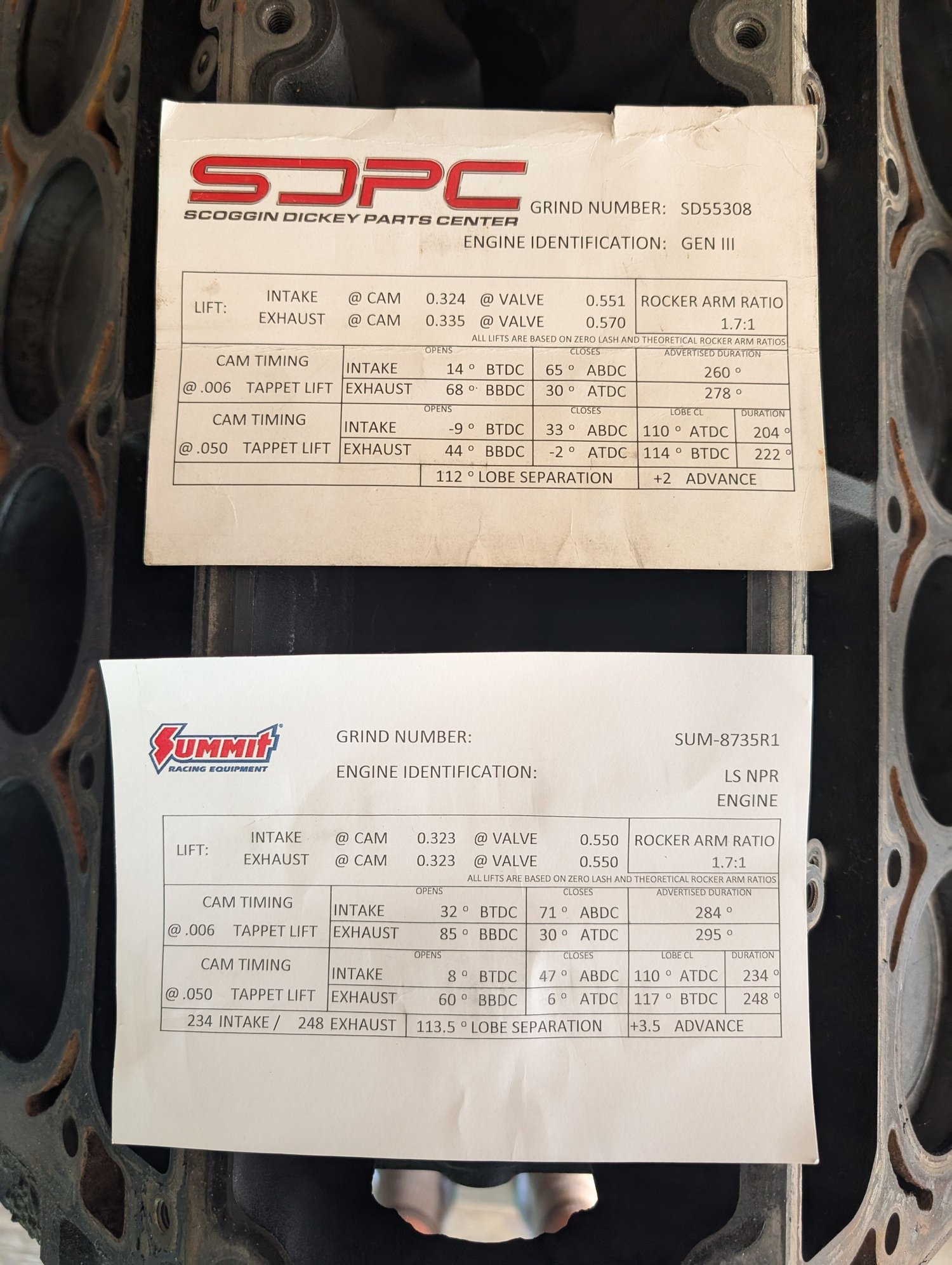

One is for a truck and one is for a car The lobe centers on the shelf never sway to far, One is for a car One is for a truck The valve springs don't cost more than a buck ?  Artificial intelligence?  Idiot proof power? Bad poetry ? Who needs to learn how to set up a valve train when there's this?  I'm ok with that just tune the damn thing so it's driveable lmao

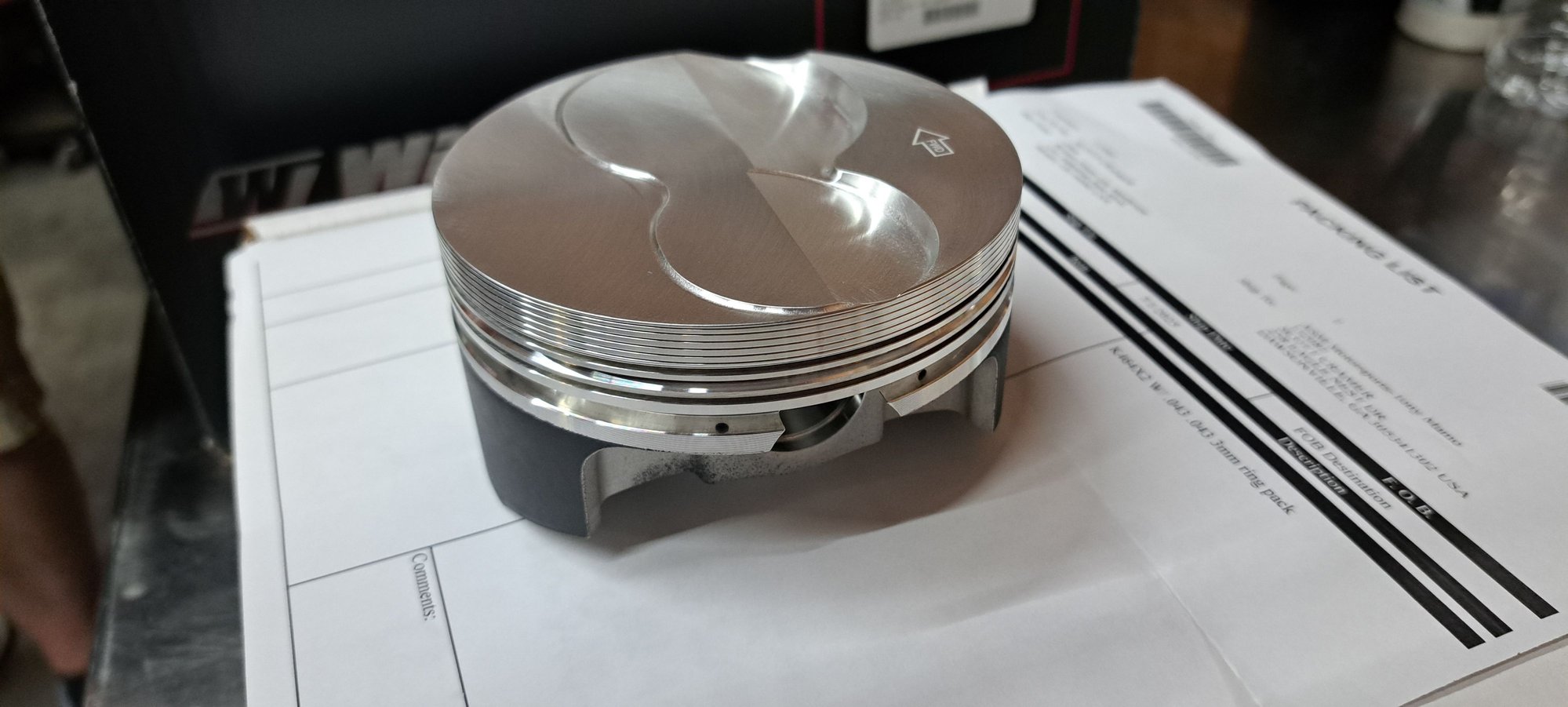

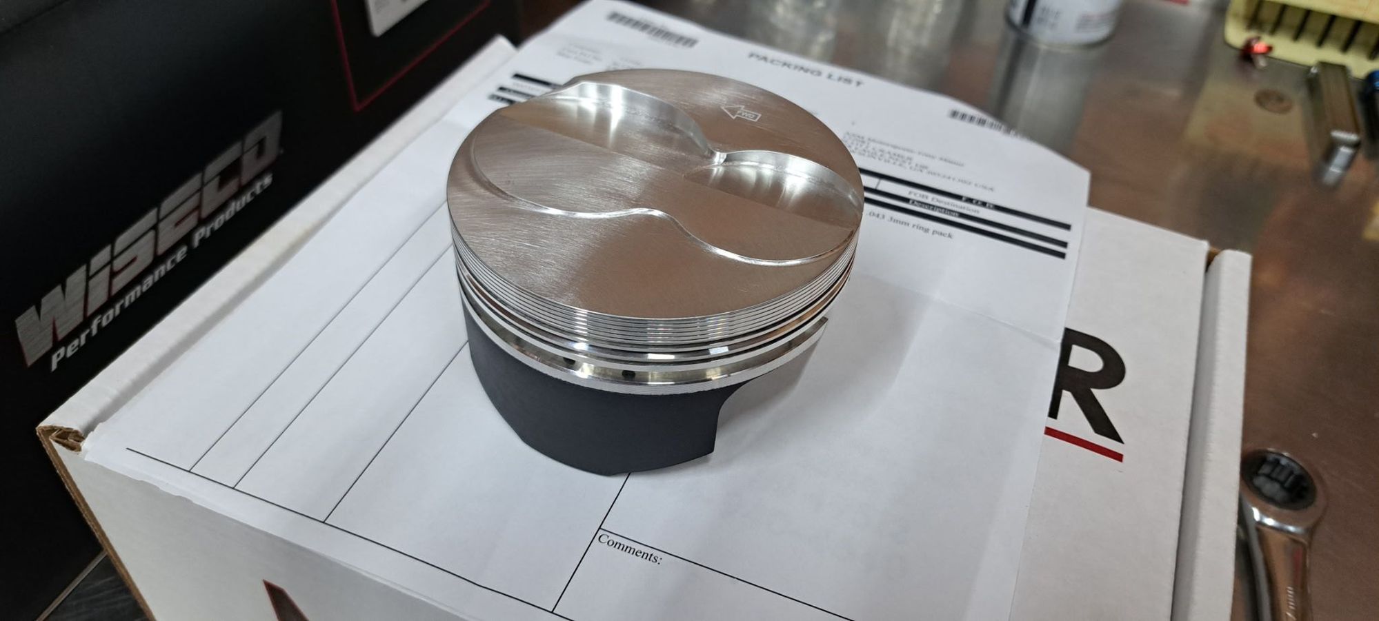

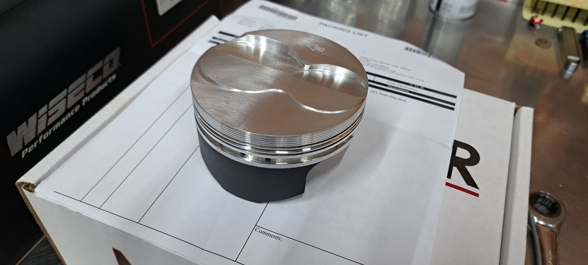

Nutter Humps FTW! In case anyone was wondering about this design...when 6.0 LS2/LQ9 flat top factory pistons had pretty reasonable compression ratios...adding valve reliefs put them well down of where they needed to be. LS people were afraid of domes, afraid of domes hitting chambers and afraid of hurting combustion and flame travel. The fix was making "domelets" that were projections of the valve faces themselves. Because of this, they can never hit a chamber and the natural dip in the middle deshrouds the spark plug. Under the right circumstanes, flow can be increased around the intake valves around tdc from filling the void underneath and combustion more complete without the void under the exhaust valve. Genius! lol.

Thanks for the props. I had these custom built 15 weeks ago or so. I spec’ed the dome design, along with Tony, to work best with what I’m building here. I had no idea Brian ever had any input on this design, although I’m not surprised. He’s a smart guy. Here’s another view of this Oreo eating beasts piston…

Very interesting! To hear the details about the design, thank you Summit.Sounds like the new 402 will be happy with these Wiseco Oreo flavor "Nutters"
Both of my pictures of the same piston.
