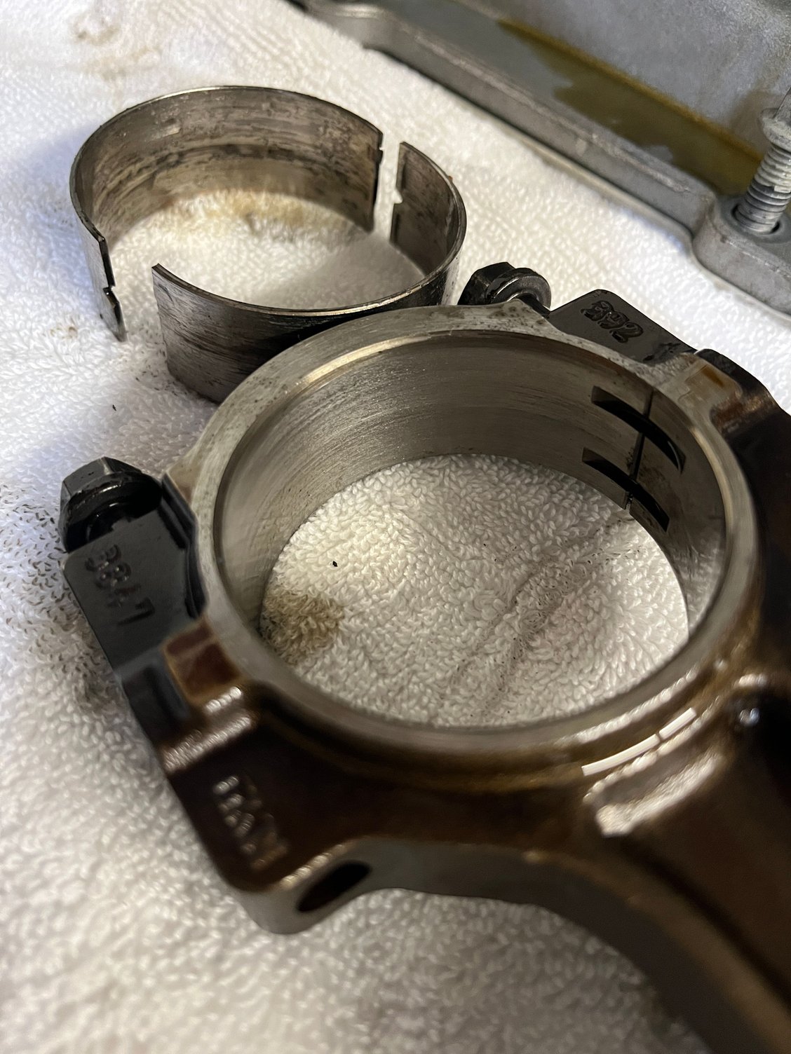

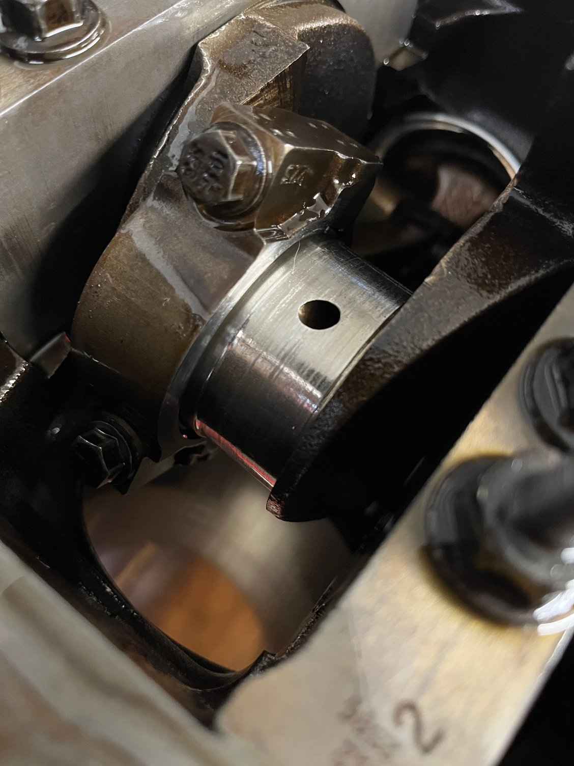

I’ll be the odd ball in the group, and say it’s potentially a rod bearing. I completely rebuilt my Lq4 earlier this year. I developed almost an identical noise. I thought it was a lifter too. Tried 2 different sets of pushrods thinking it was lifter preload. It made the noise from idle to 2000 rpm’s, and then quieted down above 2k rpm’s. After about 500 miles I started hearing a raspy noise at high rpm that I thought was detonation. It kept getting louder. So I pulled the engine and it was 100% a rod bearing spun.
