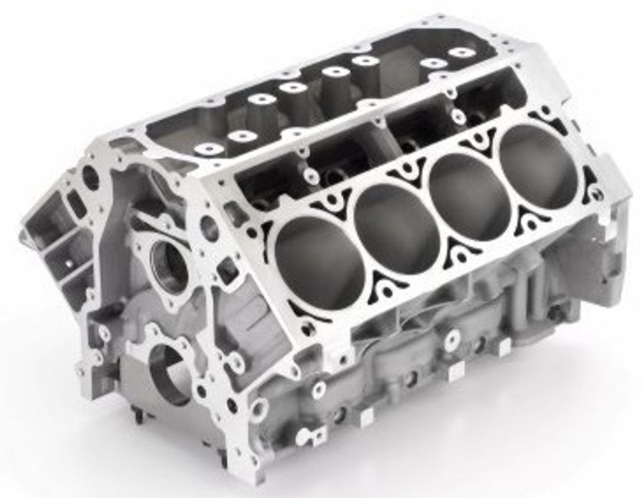

Every LS3 Block I've seen looks like this, google generic pic but still they look like this, bolted up the Melling 295 Pump up to it fine and the LS1 Fbody stuff bolts on from there..

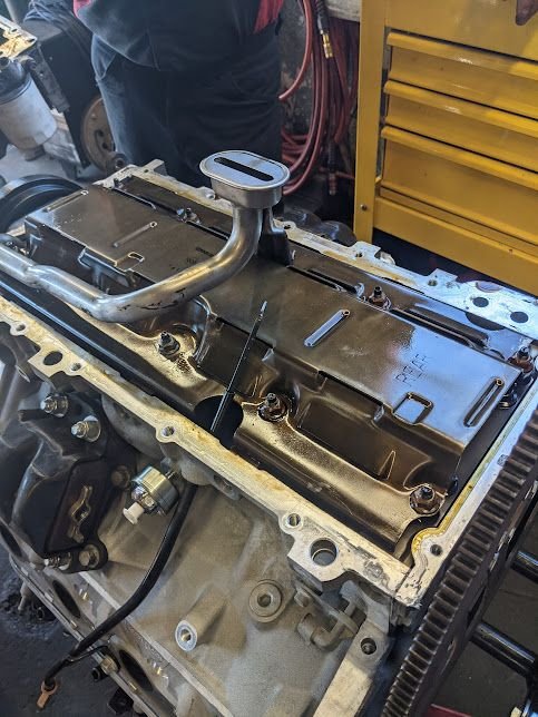

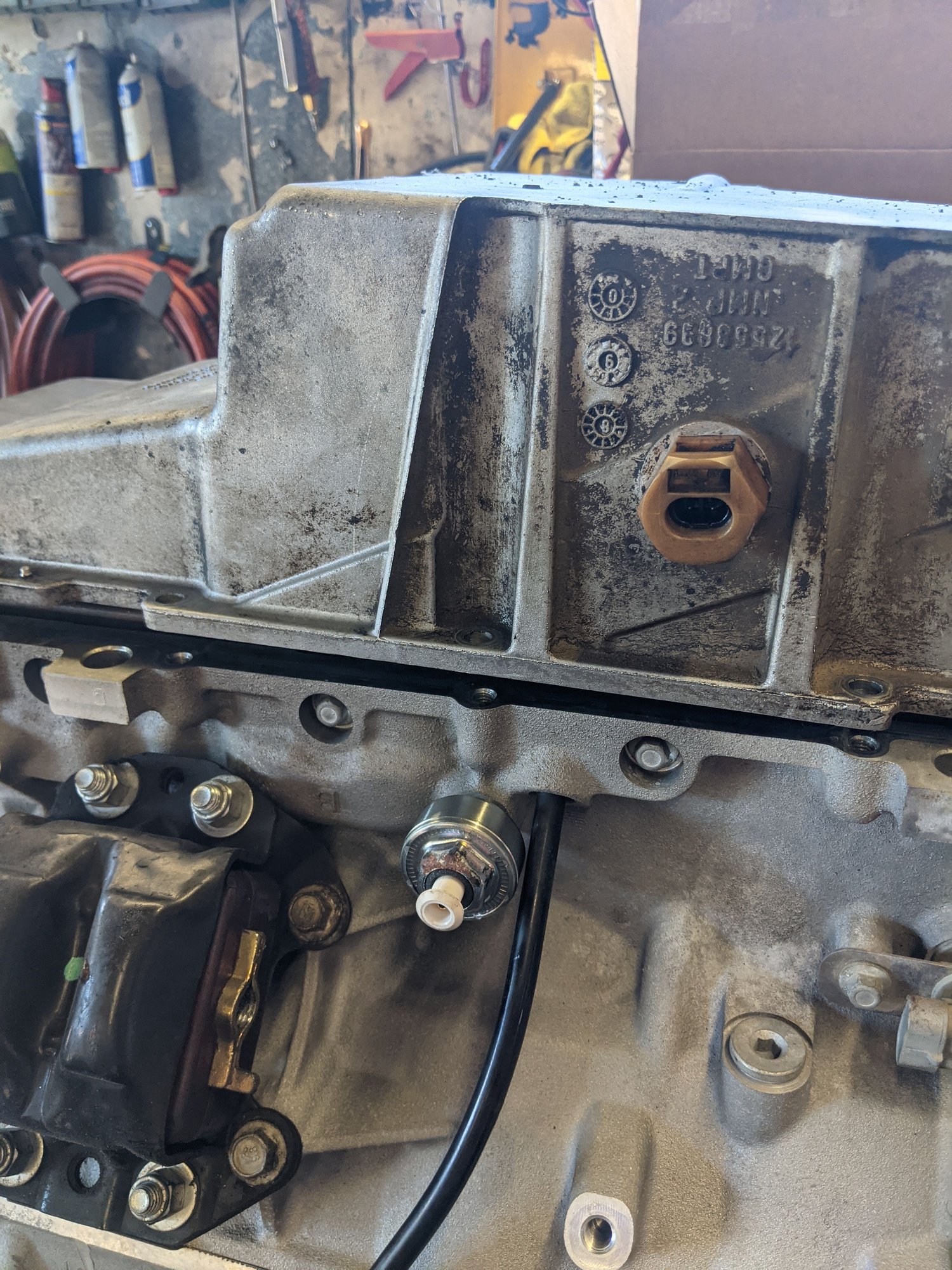

Here are the pictures you guys asked for.
As you can see, it is the ls1 pan windage tray and pickup from my old engine.
And you can see the very visible gap when I tried to fit it on my ls3

Originally Posted by dannyz
That is not a f body windage tray, that is your issue
Take the LS3 winage tray off the LS3 engine. That's your problem. The one off an LS1 is shorter, when I say shorter I mean it doesn't go the whole length of the block. It stops where the LS1 gets shallow. Switch the windage trays . Use the LS1 pan and pick-up tube. It's simple as that.
That IS the tray that came out of my old engine?
