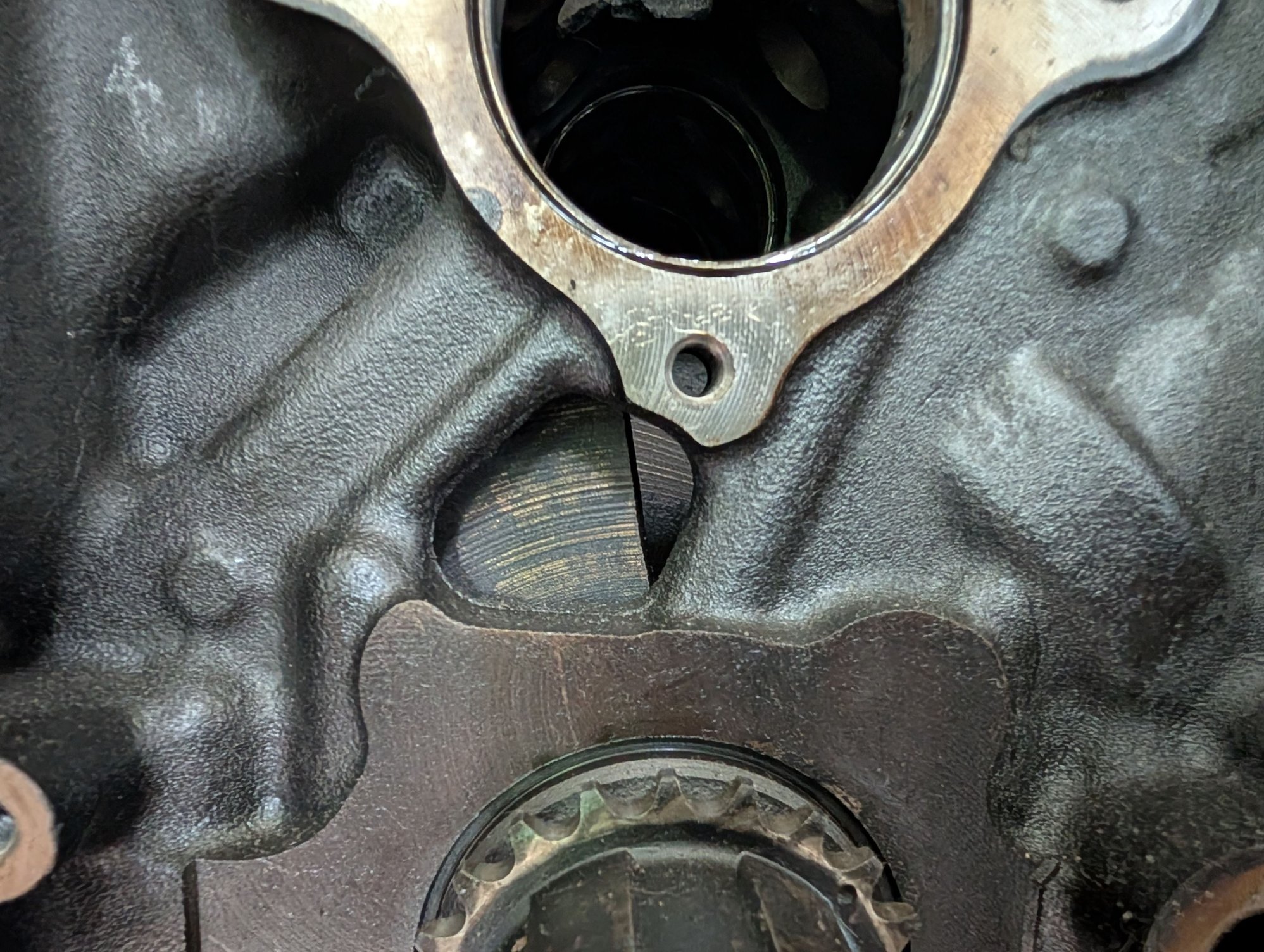

Make sure you use the right bolts For the camshaft retainer plate. They are the same thread as the oil pan, But the ones for the cam plate are shorter. If you put a longer one here it would be hitting scraping scratching on the front of the crank there
If you think it's the oil pump and you decide to pull it off check here as well

The engine is Bone stock other that the upgrades to make it work in the F-body car
