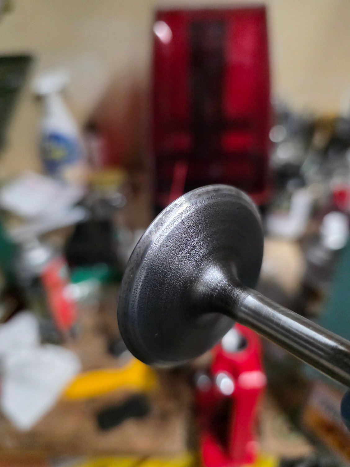

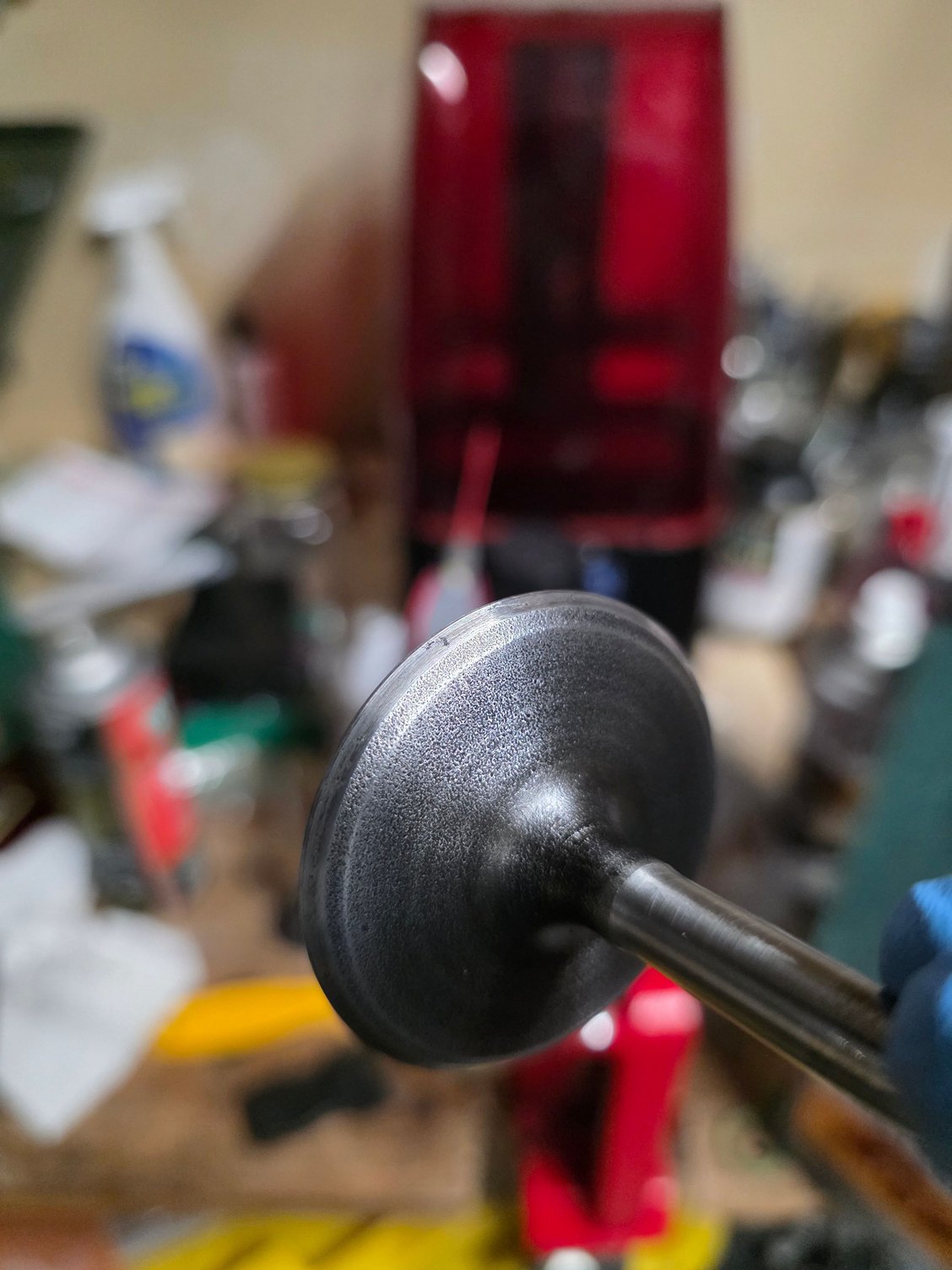

Hey all. Posting this for a friend. He got a set of used 243 heads and we disassembled it for inspection and cleaning. Came across this on the valves:
First was one intake valve had a bit of rust on the seat. It cleaned up well, but there's a little bit of pitting.
We were planning on lapping the valves in. Think thatll be enough?

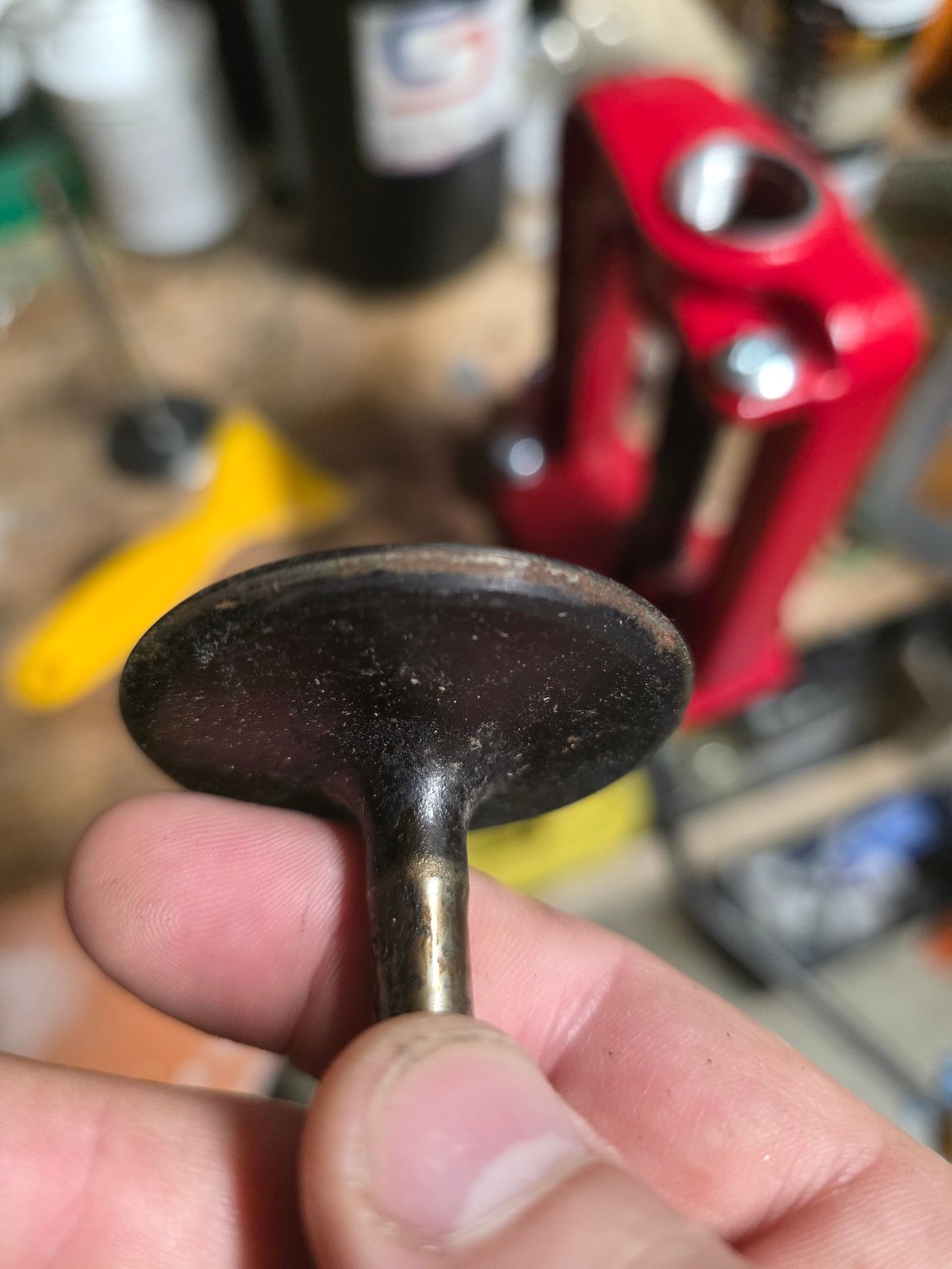

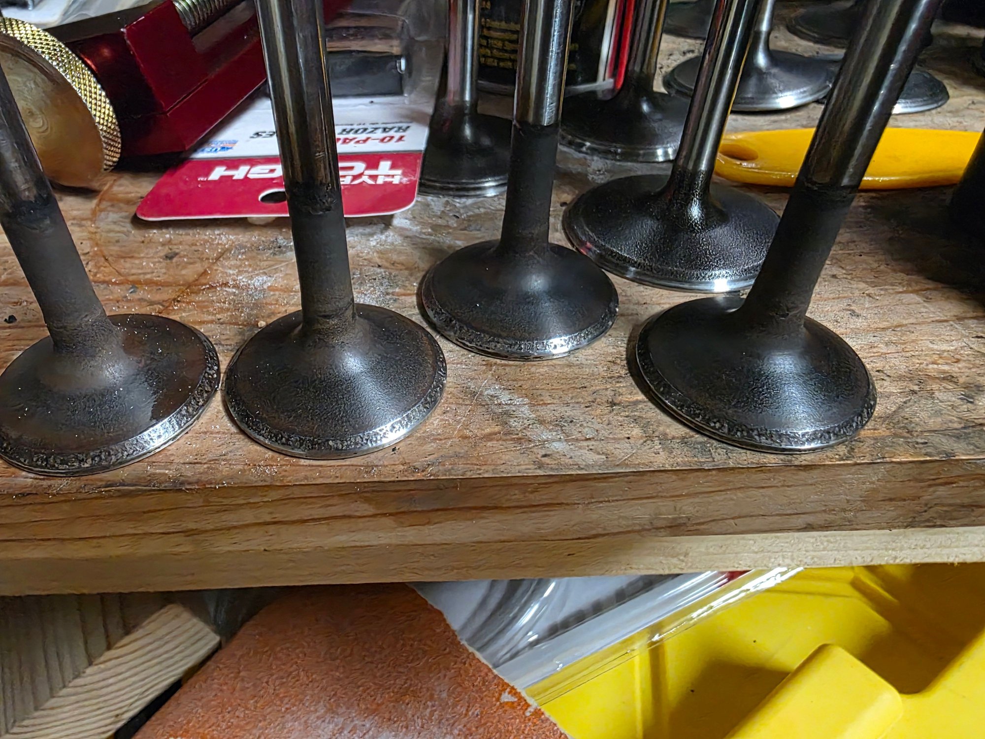

Also, the exhaust valves don't look great. hefty pitting on the seats
The one exhaust valve on the right the seat is almost completely gone.
Thoughts?

no, definitely not. I just threw some of those in the trash and put ferreas in, and they didn't look that bad. I'm sure your going to get comments either way, BUT, I'm a cheapass and I still spent the money to put good valves in. I don't like pulling heads off because I cheaped out. Did that one time, won't make that mistake again.
