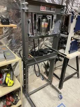

I just have one of these guys. I bought it many years ago. It wasn't very expensive. They probably cost more now but still cheaper than a shop, I bought mine manly for the differentials and rear ends makes getting the bearings on and off and in and out of stuff a lot easier

I believe that was mentioned earlier on... although all you might REALLY need is a 5.3 and a press if you already have the gen 3 4.8 pistons & rods. Not sure how the pin would be retained in a stock gen 3 piston if it doesn't have a circlip groove though; no idea whether they have that or not (I'd suspect, not, though); there used to be little PTFE buttons you could get to put in the ends of the pins that would do that for old SBCs and BBCs and such, no idea whether any such is available for these motors. Otherwise you would indeed need a gen 4 4.8 to get the correct pistons out of.
I have that same POS press from Horror Fright that stockA4 is talking about. Works well enough except that the jack leeeeeeeks which means I have to take it off the press and lay it on its back when not in use. Someday I'll try to track down paper & rubber for it butt I'm too lazy thus far. Cost me maybe $180 or some such a few years ago. I made it back the 1st time I used it (bought it to put bushings in a 4L65E if memory serves) and it keeps putting money in my pocket on a regular basis by doing things I'd otherwise have to take to "shop" or beat senseless with a hammer and risk all manner of trauma.
As far as pressing pistons, the place on the side of the piston around the pin, is flat. You can use anything cylindrical and hollow that will fit in that space and has a hole smaller than the pin - piece of pipe, old bearing inner race, another socket especially a 12-pt, etc. etc. etc. - to support the piston, and a socket or [gasp!] bearing driver on the pin. The piston itself is very thick right there and is almost impossible to damage if the rod is pressed properly since the pin itself puts no stress whatsoever on the piston, only the side of the small end of the rod. Putting them back together is even eeeeeezyer; you can heat up the rod a bit and freeze the pin, and they'll almost fall together on their own. Of course once you get your floater rods you'll never have to press em again. (well, eeeeezzzzy for me to say that anyway...)
