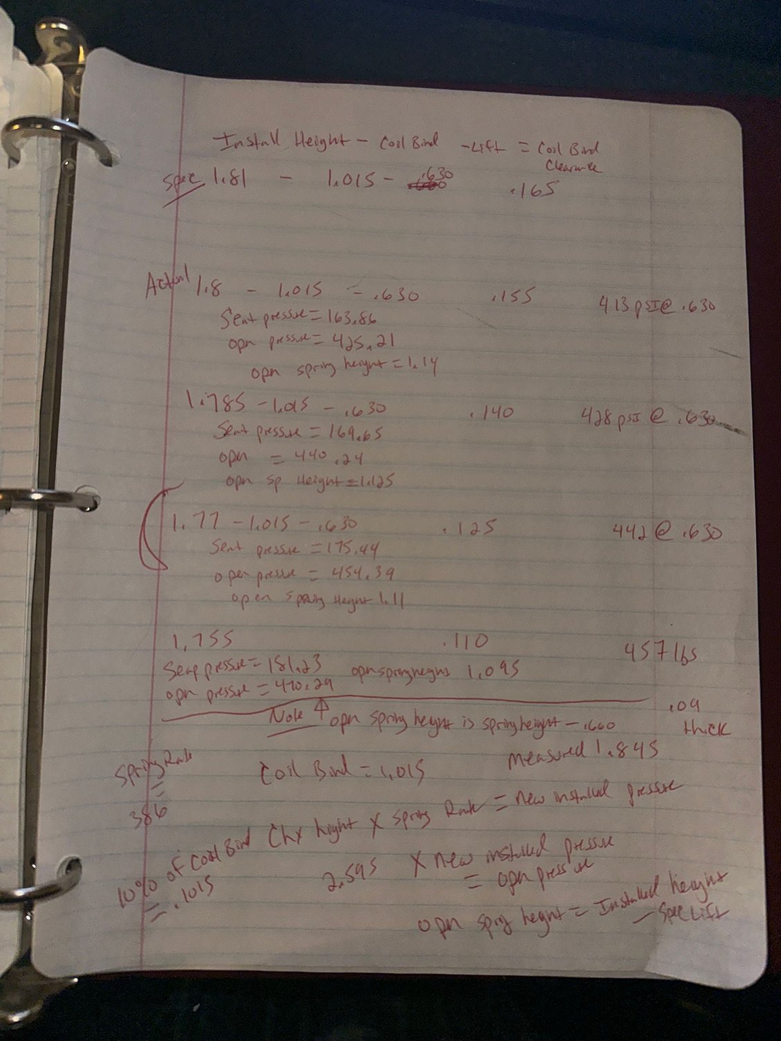

The slight increase in pressure is negligible. Without figuring it all out, maybe 5 more lbs. going from 1.815 to 1.800. The real benefit is controlling the spring surge at high rpm......

Seat pressure with ONLY a small increase (Class not full) WILL do MORE to prevent
the Valve FROM "Bounce" an Event that can "pump up" the lifter if HYD.
So that’s the reason I’m doing all this , valve control I will shift at 6800 and will def be spinning 6k when I’m on the track. There several road courses within an hour of my home
