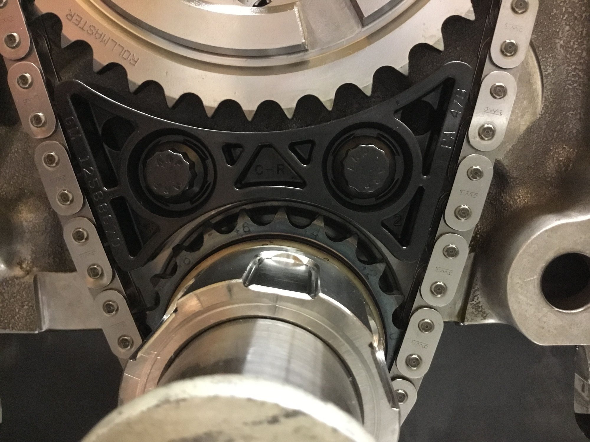

Sure. Notice the left side of the damper (pass side of engine) has more material from the outside of the fastener, to the outside of the damper. That side of the chain assembly is not in tension, and will whip causing harmonics. This offset is designed to reach out and help contain or control the whipping. This is the GM LS2 damper. I took this pic 5 years ago or so in my shop.
As far as I know the RDE dampner is the same dimensions as the old tan GM dampner....so not understanding what could make the LS2 style superior...unless GM realized they screwed up and said we need to fix this ....I thought GM had screwed up when I noticed the pass side bolt hole was not level with the drivers side ....but looking at the front engine blueprint it is by design ...in doing my research it seems that Brian Tooley Racing designed the first repo dampner after the GM became NLA then handed production over to RDE ....fun fact...my reverse engineered dimensions do not totally match that blueprint....did GM screw up my block or ???
