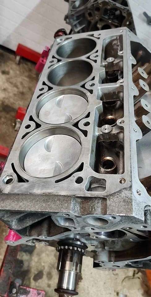

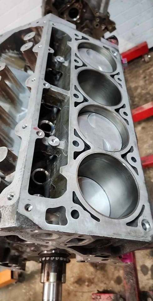

As the post suggests I know someone who has 2- L92 short blocks for sale. One has 155,000 mi. and another has 186,000 mi. each one he's asking 1300.00. I only want to purchase the block and crank from one of them. Appreciate any input on what to look for visually from either one of the setups, any trouble areas around water jackets, sleeves or other areas I should be looking at on a aluminum block? I believe that they are original and haven't been touched yet. Have not seen them yet but planning to go this weekend if still available.

Always look close at the water jackets across the bottom of the sleeves on top of the deck. If the engine has ever had water in it and froze, it will have hairline cracks across this area. The block is junk at that point.
