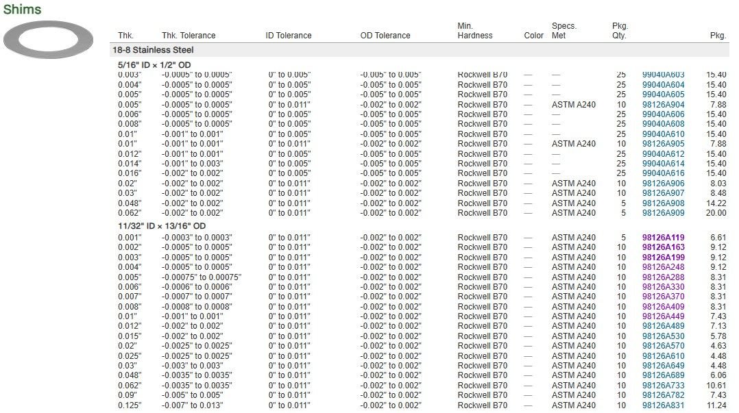

My self? On roller tipped rockers, I check for the length needed first. Then put a mock up push rod in and check the sweep. They do sell single pushrods and I have a few different common sizes to choose from. If it looks like it needs adjusting I experiment with some shims and then remeasure for the length needed once I get a good pattern.
Factory style rockers with trunion upgrade, not a whole lot you can do. For short travel lifters and to get closer to ordering 1 size custom length, I mock everything up and see how far the push rod lengths are off for each rocker. Then I add the correct amount of shim stock under each pad on the bottom side of the pedestal. Mcmaster carr sells round shims in 5 packs in .001 increments and then 10 packs from .002 up that work perfectly. I put a small amount of grease or assembly lube on them so they stick to the pad while I assemble the units. 11/32 I.D.x 13/16 O.D. 18/8 Stainless steel.
I use this tool from summit racing on stock head to measure for pushrod length. SUM-PLCLS7276 https://www.summitracing.com/parts/sum-plcls7276 I also have the OG tool from MS racing components.
Here is the shims I used from MC Master Carr. Hopefully the link takes you to the shim page. But if not here is a screen shot. You can stack shims too in order to get the right thickness so you don't need to buy every size. I think I did .001 - .004 and one of them was of .007 so I just stacked a .004 and a .003 to get the .007 Measure first, then order what you need.
https://www.mcmaster.com/products/98126a119/
