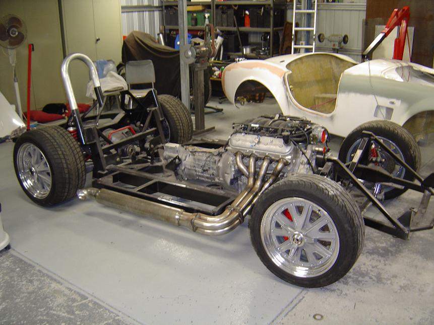

Hi Guys,
I'm building an LS1 powered Cobra and looking at warming the stock motor up a bit.
I've been reading all the cam posts on here and I'm getting a bit confused as to what cam would work well in my Cobra.
I'm running an internally stock LS1 and 6 speed. I've built my own 1 7/8" long tube headers running into 3 1/2" collectors and there's no EGR. I've ported the stock throttle body and I'm currently building the cold air intake. I'll be running MAFless with the ECU tuned via LS1 Edit.
The car will weigh about 2300 pounds. I'm using a light weight 15 pound steel flywheel and spec stage 3 clutch. The rear gears are 3.9 and the rear tyres are 315/35/17
I'm not running any AC or Power steering.
At this stage I'm just looking at changing Cam and springs but I'm planning on machining up an 8 throttle body manifold in the future and maybe porting the heads.
The car is going to see mostly street use with occasional trips to the drags and the circuit. A lumpy idle is OK since it's a Cobra and it's supposed to be a bit lumpy.
I'd like a cam that doesn't need piston mods to clear the valves and springs that will fit on the stock heads.
Some of the 226/232 and 231/237 grinds sound appealing.
What cam and springs would you guys reccomend?
Cheers
Mike

that, my friend is ****** pimp
traction is going to be your biggest issue, i'd keep the cam relatively small since you already will have a great power to weight ratio. a tr224 112 or tsp 225 112 should fit your needs fine.

you have any more pics of the car/setup? those headers look badass, are they completely stainless steel?
The headers and side pipes are just mild steel and I plan to get the whole lot HPC coated. The side pipes are re packable have Cat converters in them to meet Aussie emissions laws.
There are a bunch of pics of the build to date in my gallery on Club Cobra: Mikes Gallery

WOW... goodluck on the finish... I suggest the TR224 cam as well! good street.strip cam!!! AWSOME RIDE!
