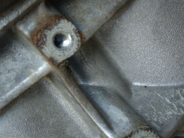

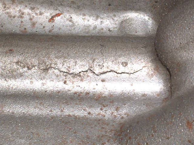

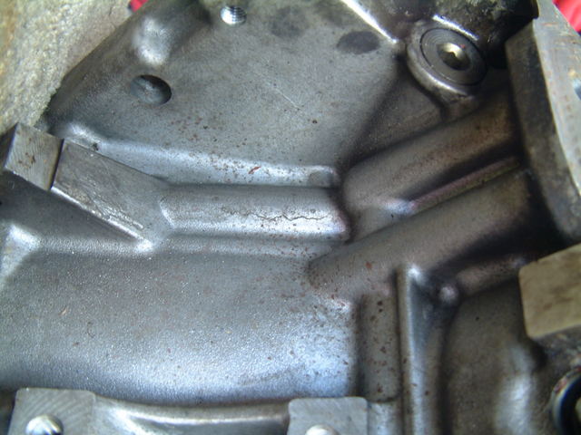

I got a 98 block off a guy on this here forum sight unseen! He guaranteed that it was a builder, good condition etc. Once I got it I found that the block was hydro cracked from torqing down the cylinder head with fluid in the bolt holes. Only one looks really bad but at least 3 others are visibly cracked. I can weld these things up and helicoil if necessary but I was told I was getting a good block ready to build so should I attempt to repair the block or try to get my money back? Will it need helicoiling or resizing to 1/2 studs? Here are a couple pics...
????? I paid $200 for the block with all the covers so at least I'm not out a lotto money but still I would have not bought this if he had given me any indication there were cracks or that it was not ready to build...

Nah, I've used blocks that were cracked like that and they held up just fine. Just weld it, chase the threads, and then do your normal machining (line bore, cylinder bore, hone, etc.). $200 is definitely a fair price for the block, but I think the seller definitely should have disclosed the crack if he knew about it.
In fact, I have two in the garage right now with cracks that I fully intend to use

WTF, I need some practice welding cast aluminum so I hit it. all the dirt in the casting makes for a pretty nice mess but I got it undercontrol pretty much. feels good to hit some aluminum for a change. found out my welder DOES need a 100A circuit for this ****. lol
well here's some images. kinda fugly cause I touched down a bunch or fed the filler to the tungsten. next one will be much better (hope not to need to do this again).
the middle pic you can see I had to go nuts on. it was the worst and the first i tried. the other two went much faster and smoother. think I have the "trick" to doing this worked out now.
