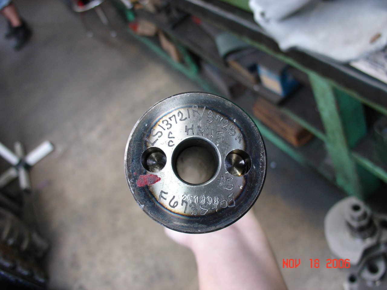

What Cam is this?

222/223 XER according to CC lobe catalog

Are you looking for what the grind numbers translate into?
If so, I'm pretty sure its:
3721R = 222/.581
3723R = 226/.585

Oops, maybe not.
3721R = 222/.581
3723R = 226/.585
Well you're exactly what I think they should be. With a 115 lSA

115 Lsa/110 Icl ??

Looks like most people that etch cams have an epileptic seizure in the process.
