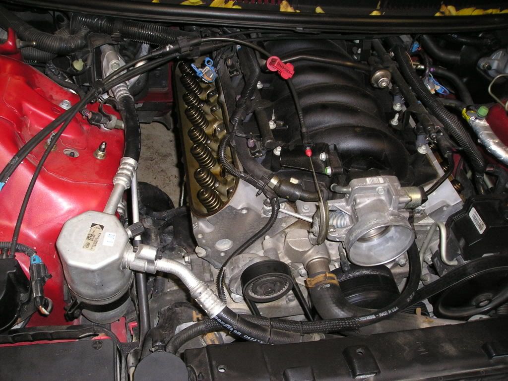

Well..the pushrods were all straight as an arrow, so it looks like I am pulling those heads to do lifters before the cam goes in. Where is the best place to get a longer ballancer bolt?..
