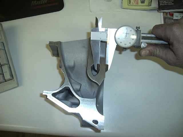

The deck thickness on the production L92 heads measures .500".
The LSX L92 heads have an additional 1/8" of thickness.
I haven't been able to section a LS9 head yet so I don't have a clear answer. Sorry.
