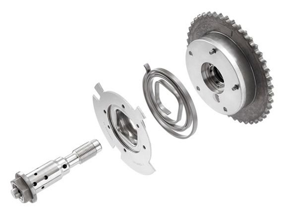

So I just installed the comp cams limiter kit. Problem is that that screw they say not to remove, yeah I removed it. However, I only removed it after installing the other screws back in (I wanted to loctite the screw so I took it out). Question is does anyone have a side view picture of the cam phaser where this bolt is? It is a pin bolt and I'm trying to find out if the pin should go inside the spring or outside the spring (right now its outside the spring, which means if you look at the phaser sideways there is two visible pin bolt ends showing)

See how there is two pins poking out in this picture, that is what I'm trying to see from the side.

Did you find what you need? I have a 994 phaser in my hands, but I'm not sure what you need a picture of
http://i44.photobucket.com/albums/f4...psxlic9crf.jpg
Hope this helps.
