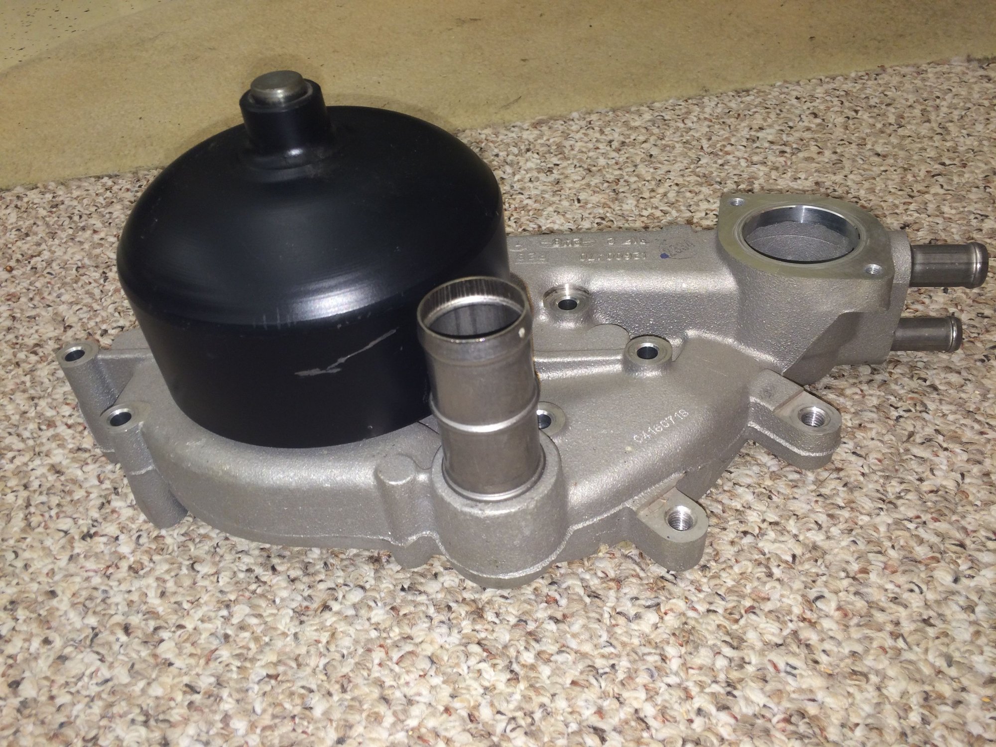

Which model engine did this water pump come off of. I was told it was an LS7 but it doesn't look like one (if I had to take a guess I would say LS1). I am putting it on an L92/LS3. Will it work? Is it worth $85 or so if it was a brand new take off?

Looks like a Gen 3 pump to me but if you google the part number on it you can probably narrow it down more.

Tried that with the 120xxxxx number and nothing came up. Even went to a few GM sites and put the part number in.

That looks like a 98-02 fbody or GTO pump. It will bolt to an L92, but the stock spacing for the L92 truck accessories wont lone up with it.
