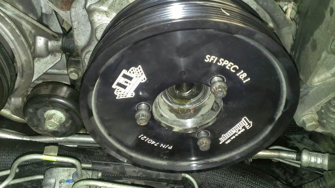

It seems there are not other spots to grab the pulley other than the outside ring. How do i get this thing off?

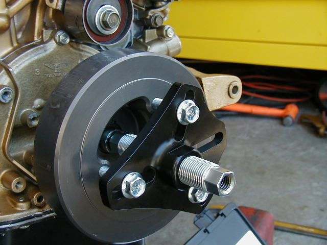

Here is my setup... I'm guessing the 3 bolt holes are for pulling it, and I need a setup similar to the 2nd pic? And i now need the special removal tool? Wonder if any local stores will have this?

My name is Ivan and I work for Fluidampr. You have it correct. Remove the 3 bolts then use a puller just as shown in the second picture vs. using a 3 jaw pulley which may damage the aluminum pulley. You should be able to get the removal/install tool at a local auto parts store. Most will let you use them with a refundable deposit.

Get a proform pulley removal from summit.! And use grade 8 and above bolts.
