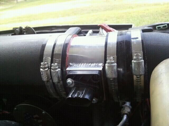

You don't need to get rid of the lid, you can put a small coupler inline with the lid and then TB on either end of the MAF.
Kinda like this. It's a 4" spectre MAF housing and LS7 MAF along with 4" tubes and intake.

Looks easy enough. Thanks a lot. I can ebay that stuff. I think I'll need an adapter harness from 5 to 3 too correct?

Is that a spectre 9705 maf housing?
Yep, I run the same on on my car....Screw paying 300 bucks for 75 dollars worth of parts

Great! I was gonna go with an 85mm GM MAF but after doing some searching I think this is a much better setup. I ordered the LS3/LS7 MAF 15865791 & this adapter harness: I will get the tube & couplers to connect it to my 92 mm TB.
