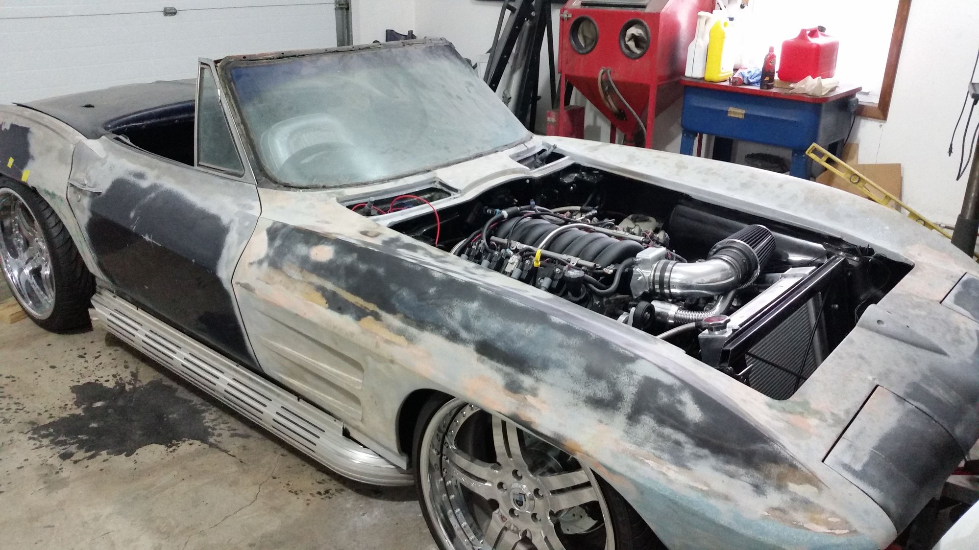

Ls2 bottom with gm performance ls3 heads, ls9 head gaskets, ls3 intake, nick Williams 92 mm TB,big cam, medium headers into 3 inch unbaffled sidepipes , and a muncie 4 speed tranny. My car has been in a shop getting some work done and I want a idea what kind of horsepower it should have because something was wrong and it started at about 240. It seems after researching it should be over 400??? Thanks

It made 405 to the wheels. The tuner said my compression is low due to head gaskets being to thick. Not why since they are ls9 gaskets and are supposed to be the same thickness as ls2 gaskets. The compression maybe lower then a ls2 due to the heads being larger chamber then the ls2 heads. He said I would pick up 25 hp with the correct compression. Could I or should I mill my heads to get the same compression as a ls2. My pistons do have reliefs in them but I didn't check valve clearence. Thanks for all the help!!

Stock LS3 heads are 68.5 cc's so you'll be around 10.7:1 compression ratio with your set up. I'd say 550-575 hp at the crank or 460-485 hp at the wheels. It looks like a very nice project. Good luck with your build.
