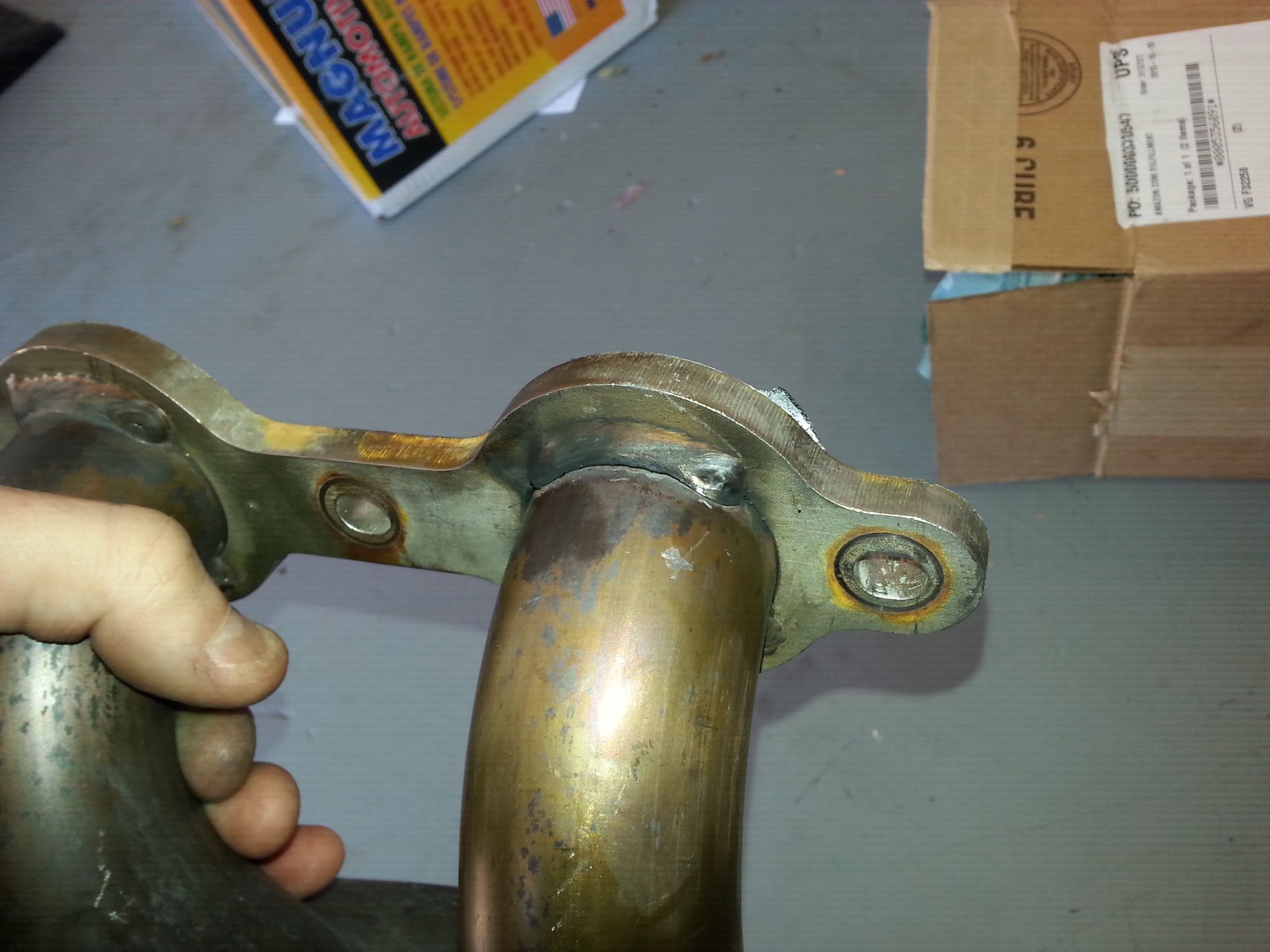

Is this header primary weld leaking?

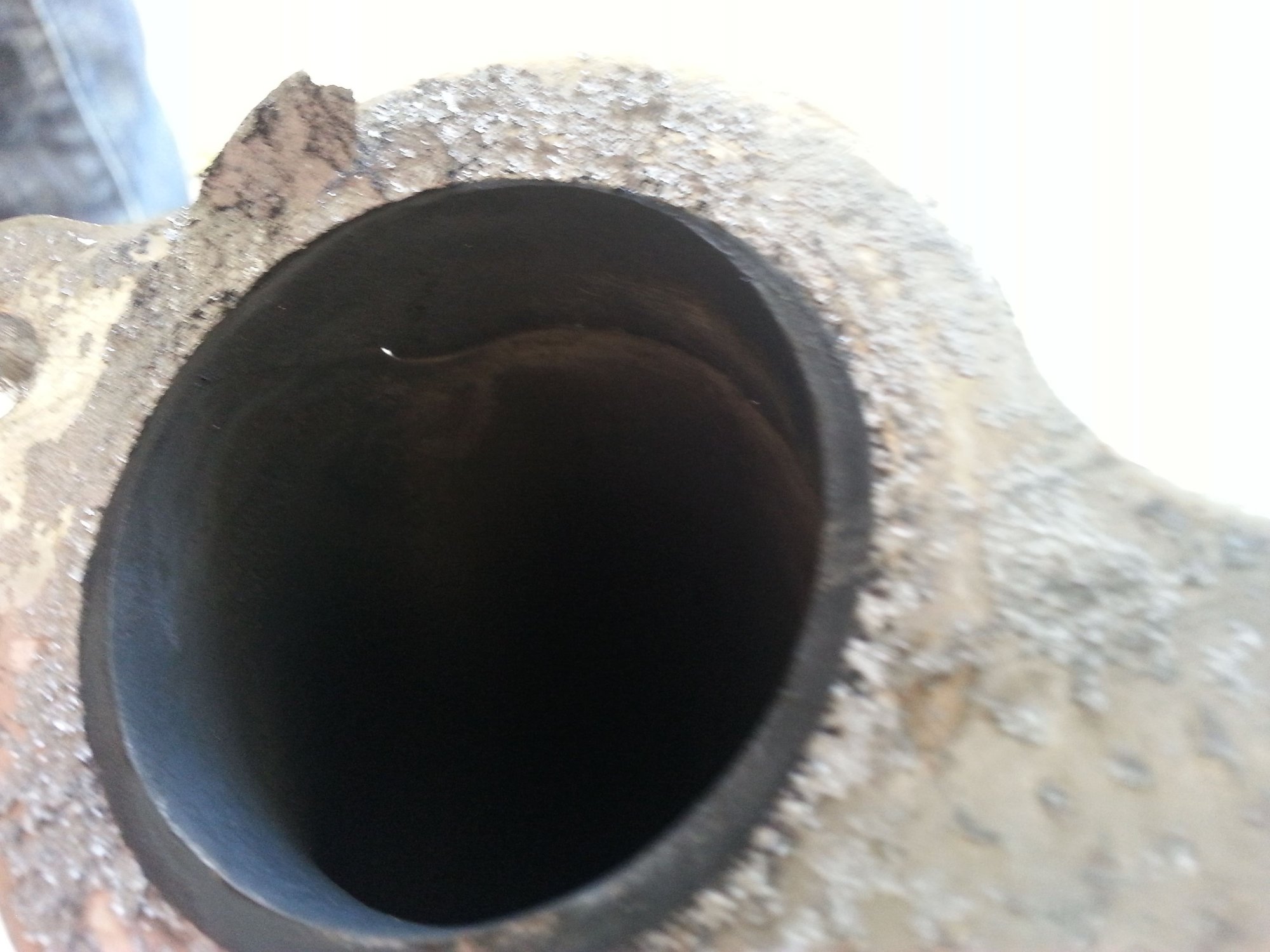

If they're not that off then it's not going to be a problem.
Take the header off, color the surface that touches the head with a sharpie, wrap something solid and flat with a piece of sandpaper and give it a lught hit to see if that's the problem.
Warping happens from the welding process not from being on the car.., sanding it flat post welding will not be a problem. If it's even an issue at all
Old Nov 8, 2015 | 12:37 PM
mchicia1's Avatar
Joined: Apr 2009
Posts: 888
Likes: 9
Found it! The weld was leaking! I am relieved. It looks like the weld below that pinhole is going to come apart at the seam too.
Should I just have a local shop weld that pinhole or should I send them back to ARH?

Send it back..... Or get a local welder to fix it. If you were local to me I'd offer to do it.
Very generous, thanks
I will ship it out tomorrow.
Are you in CT?
Eastern pa. Nick from arh said hed take care of it for me only 15 bucksto ship through fedex too.
