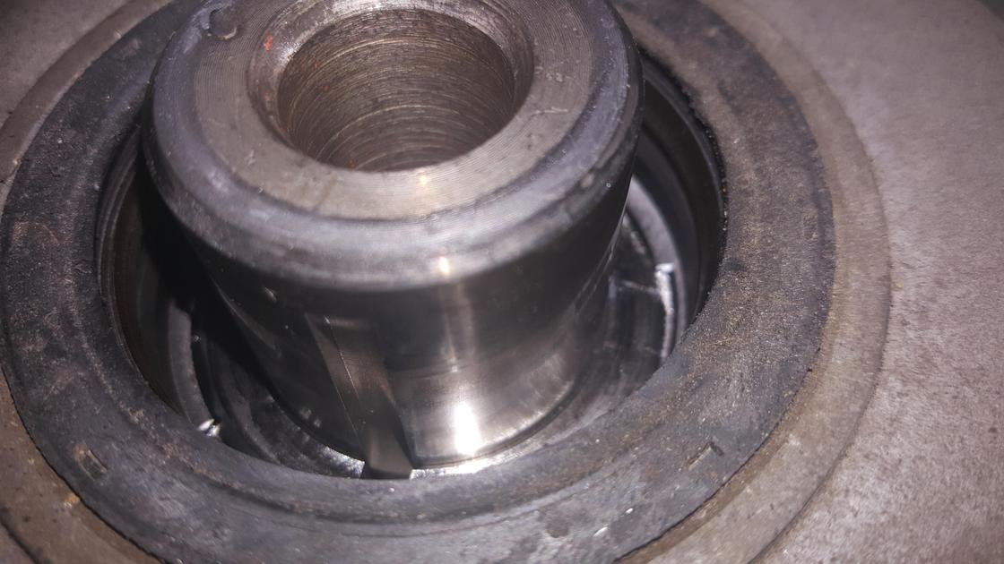

I have an 05 GTO with an aftermarket Manley crank. I'm installing a Procharger and need to pin the crank. My crank already has a keyway machined into it so can I buy a longer key and use that instead of drilling through the side of the crank with their "pin kit"??? I can't find any threads of people doing this so I figured i'd ask. Thanks

Yup. Just need the key. The ATI comes with one. Should be in your box somewhere. If not, your local machine shop should have one.

Yup. Just need the key. +1

Key. Gm sells them seperate
