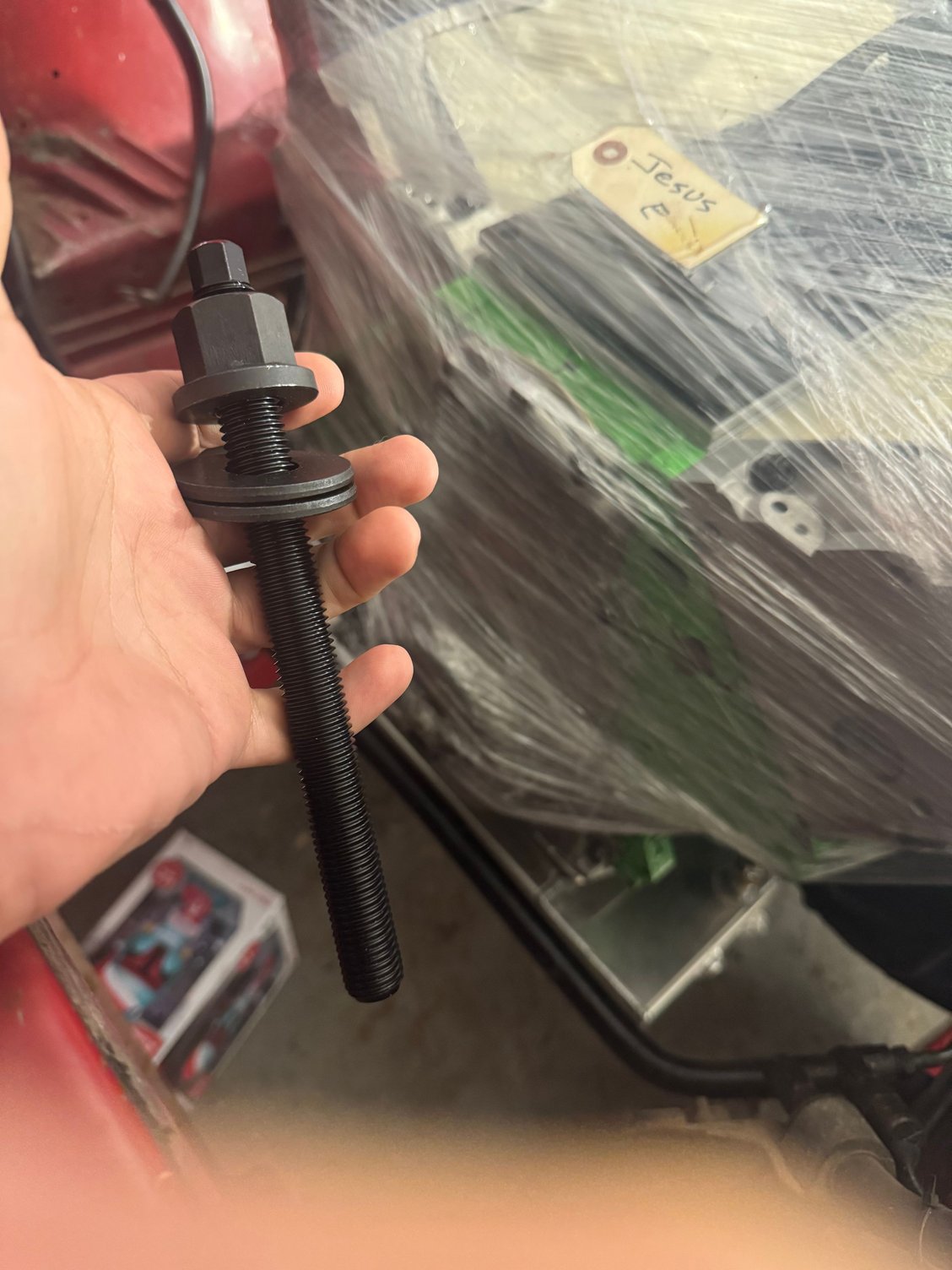

I did consider going with the ARP but decided not to because I do not plan on taking the bolt out again. If I ever do, I will upgrade it to the ARP bolt. This is the tool that I got off Amazon, image below. I’m just paranoid about doing it wrong xD. I keep reading other threads where the bolt came out because it wasn’t don’t properly.

Yeah, that installer will work. I bought one with a bearing so it's silky smooth going on, but as others have said, just grease it well and you'll be fine.
