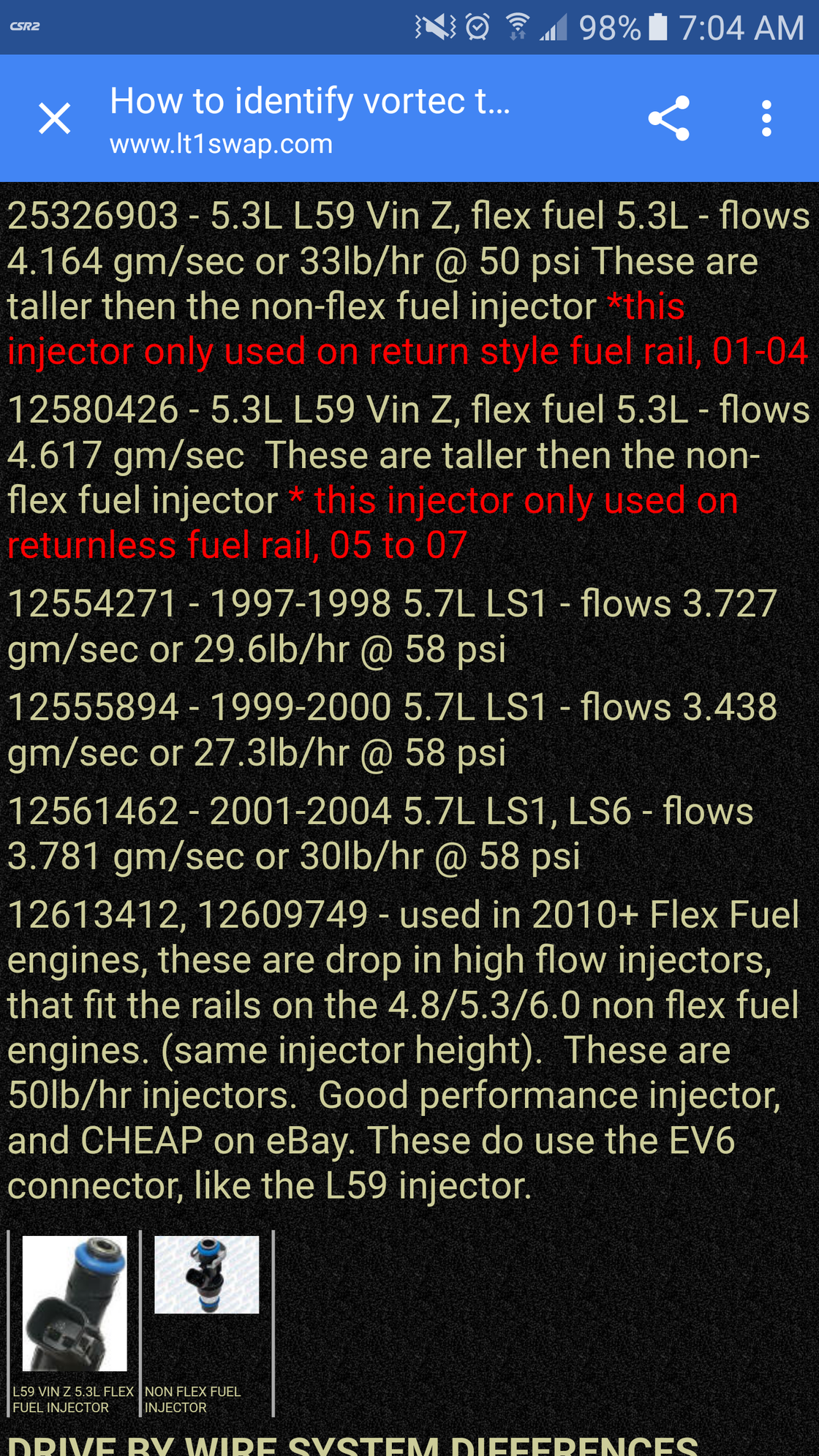

So on my big search for cheap injectors that don't come from China, I realized 2010+ (flex fuel only?) Are 50lb injectors. Will these work in a fuel rail from an 02, and I just change the plugs? Be awesome if someone knew for sure one way or the other since a new set of 8 is only around a hundred bucks rather than $300 or so for a new set of 8.1 marines.

I have a set laying around.
Yes, they fit.

The 50 lb injectors. I'm not selling them.
The good thing about truck injectors is that they are the shortest ones, so basically any injector will fit the truck intake/rails with a few washers to space the rails up.

Oh. I miss understood. You must put the rail with the injectors on, and then just put whatever you need for washers in before you bolt the rails down?

It should be fairly self explanatory if you go to put the rails on and the injectors are too long.

https://sites.google.com/site/sloppy...torspacerhowto
