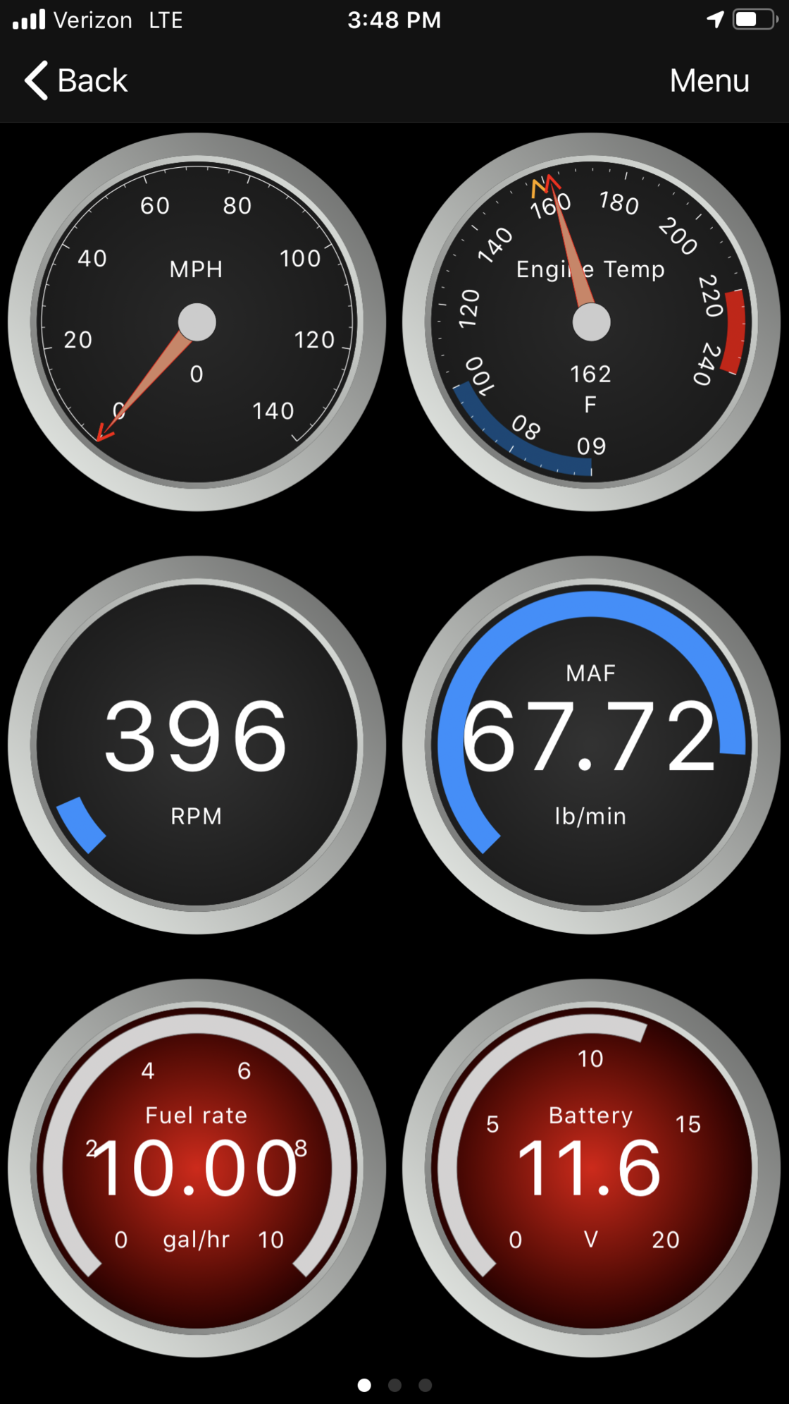

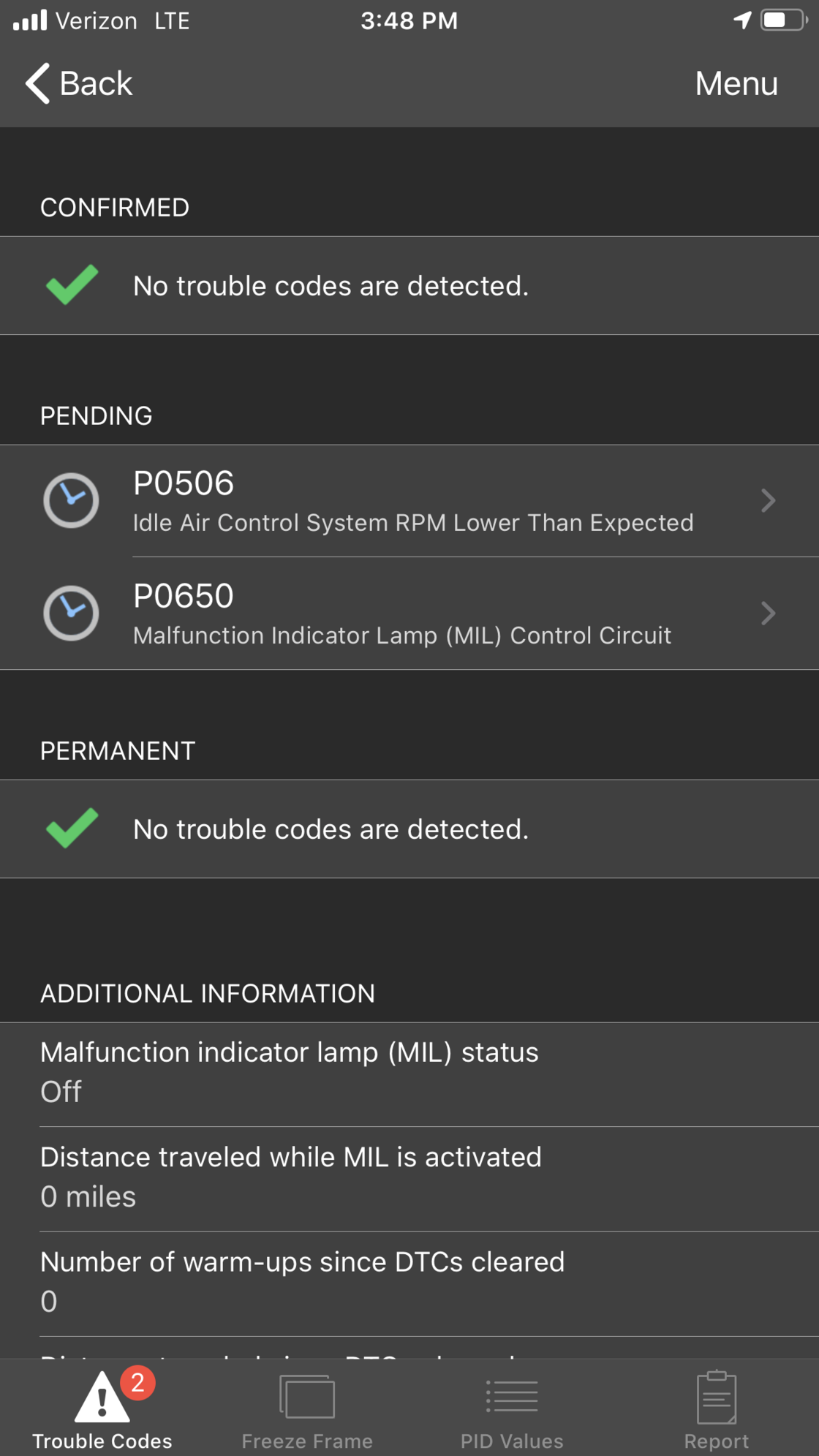

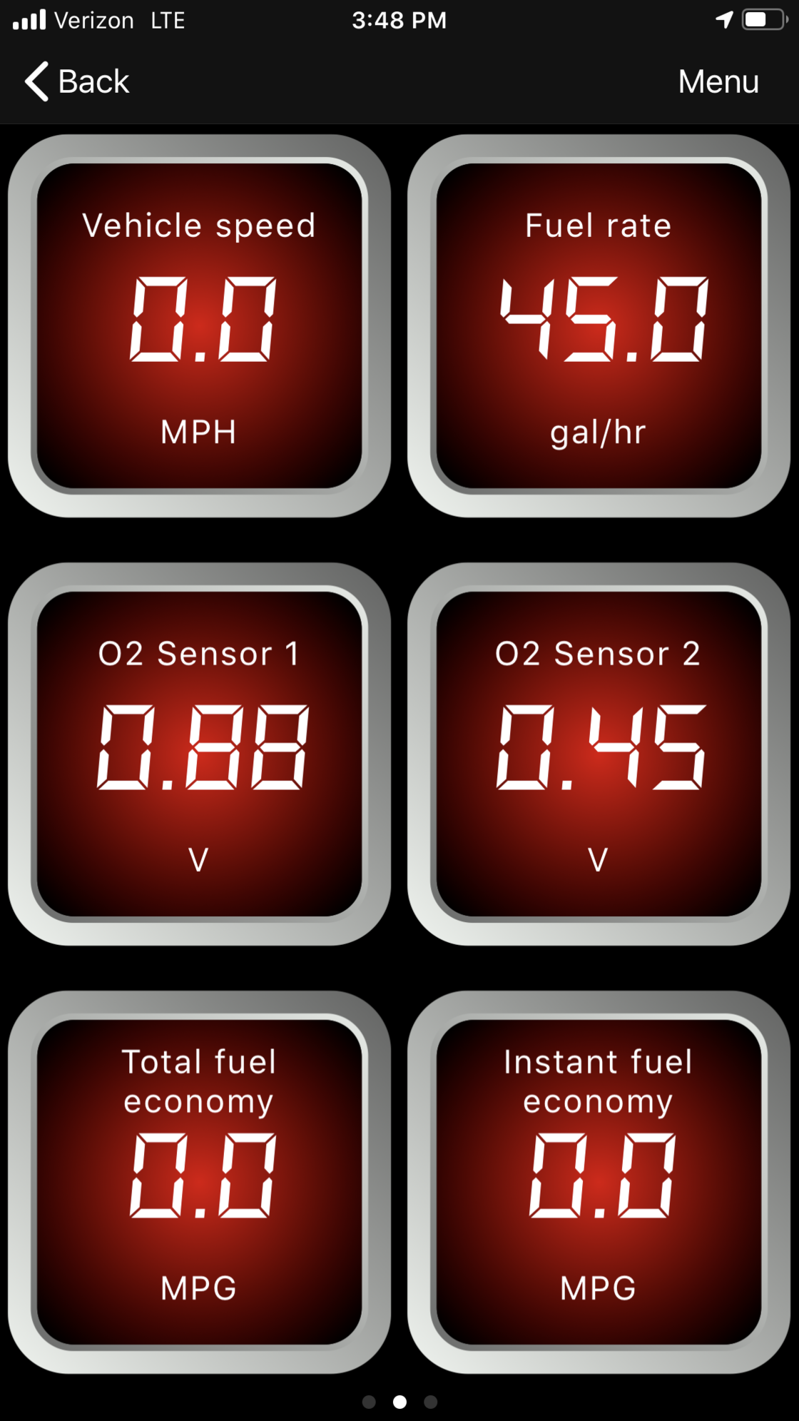

I hooked my scanner up to the OBDII port and I pulled two codes. One is a P0505 - Idle air control system lower than expected, and the second code was a P0650 - malfunctioning indicator lamp. I also snapped a few pictures from the OBDII bluetooth gauges while the car was running (see below). The battery voltage seems low, and the O2 Sensor readings are high. Also it seems like the MAF readings are high, but I am not 100% sure.

Check for exhaust leaks ahead of the O2's. Air leaks in, fooling the O2's into thinking it is a lean mix, throwing way more fuel into the mix, making for a VERY rich mix.

Wanted to close this thread out. I smoke tested the engine, and quickly found out what the issue was. My MAF housing had cracked behind the sensor allowing extremely high MAF reading. I have replaced the senor housing and the car runs good now. If anyone has an issue similar to this, and car read the MAF senor the values should be around 2 to 3 lb/min. Mine was reading around 67 lb/min.
